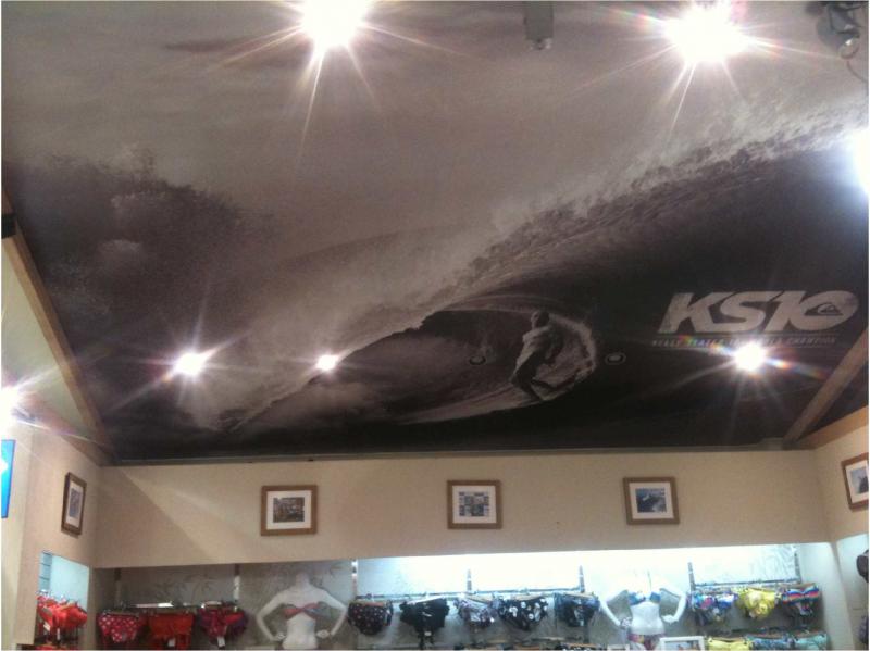

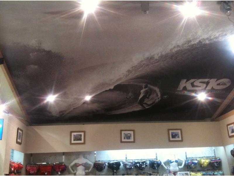

This time round the client only wanted one bay's image replaced. We printed and laminated the image, set up scaff towers after hours in the store and fitted 8 x 6m planks between them (the QS1 image shows the setup) to match the pitch in the ceiling. There were 5 printed panels in all, each about 1300x5000mm.
Although we'd planned to do the job using wet application, we found (the hard way, on the first tile) that the vinyl didn't want to stay up with water around, so we sucked it up (no pun intended) and did the application dry. It went down beautifully; we just used a heat gun to ease out any wrinkles or bubbles in each panel.
QS3 shows the finished product. It took all up about 6 hours for two blokes, including scaffold setup and strikedown.
