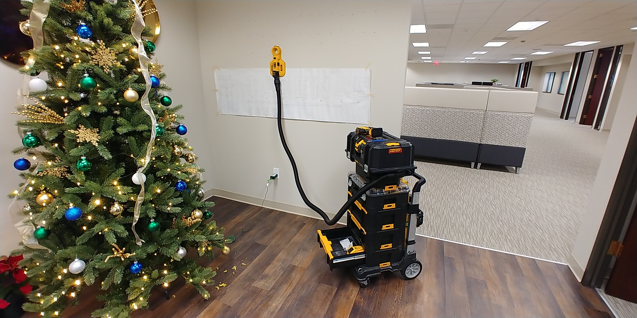

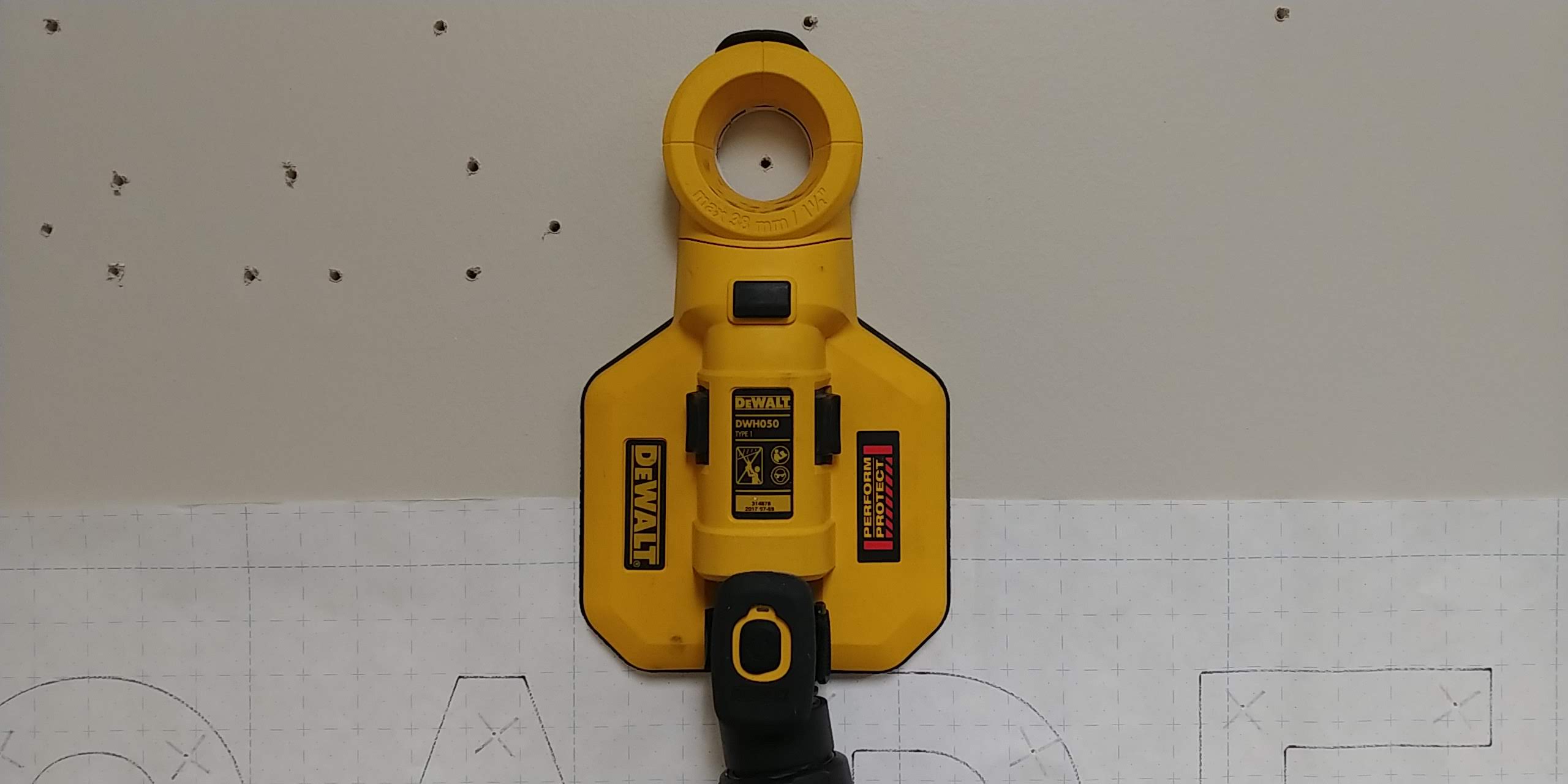

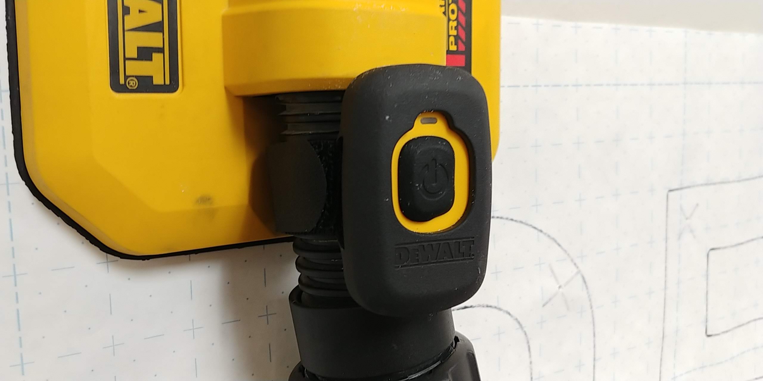

Rather than get drywall dust all over the wall and floor, I've been using the DeWalt cordless Flexvolt extractor and the suction ring. The extractor comes with a fob that you can put on your wrist or wherever. I put it on the hose of portion of the suction ring. It lets you remotely turn the extractor on and off.
This is used by most trades for concrete drilling/dust extraction. I've used it quite a bit for that as well and it works great. For parking garage installs, I leave the entire setup in the van and attach a 15' to the 8' hose it comes with. I just park in the vicinity of where I'm installing and have dust-free drilling. It's great for working overhead, on floors, walls, etc.
