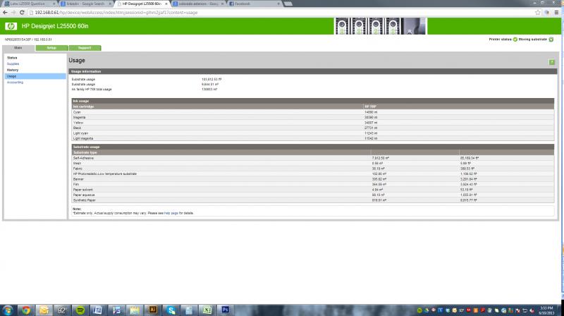

HulkSmash
for 100k + sqft, your #'s should look close (L through PH's) to these that are through one of mines
We're changing out 3-5 a month +
