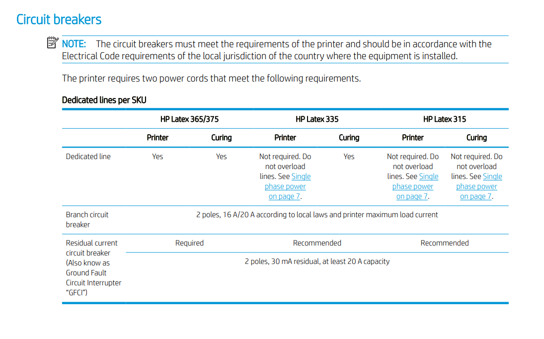

She may have needed service had to be upgraded to cover the added draw, but yeah it's 2 20amp circuits.
That isn't correct. You need two outlets on a 20 amp circuit. I have had a 315 for 5 or 6 years and have been running it off a single 20 amp circuit.
ikarasu
I believe the 360 specs a 20 and a 15 amp. Can you run it off of 1 20? Probably, but your taxing your wiring and breaker.. odds are you'll be fine, but just wait until it starts a fire and they say you weren't following the spec so no insurance payment for you.
ikarasu
So the 315 doesnt require a dedicated line... But the 365 uses more power and amperage and does require a dedicated breaker.... Should be verrry careful when posting about power requirements that could potentially burn someones house down at worst, or at best cause them to have to bring an electrician out a second time once they see their breaker keeps tripping!
shepherddesigns
My comment was 315 specific. HP documentation requires 2 poles, 30 mA residual, at least 20 A capacity. Max load printing is 3 A and for curing is 13 A.
