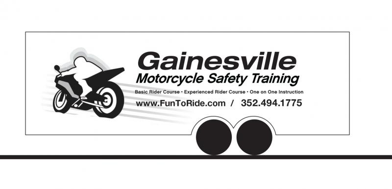

I can appreciate Rick's layout and design. From an install stand point, using 751, that'd be a nightmare. Considering the rivets on the trailer, that design would have to be implemented with 'wrap' materials.
Here's the same layout, simplified for a true cut vinyl application.
  • motorcycle-simple.pdf
joshGN
Another thing to consider, the passenger side of the trailer most likely has a walk through door.
I'm interested to know how others approach this hurdle in design.
Do you shorten the total image to not over run onto the door? or just do it exactly as the driver side?

John Butto
just black
I took some ideas from Rick and Josh and just made it real simple as far as the lettering. The motorcycle I did with Illustrator that I had drawn for something else and it does not really need the gray shades. The newbie just needs to buy a roll of black and use Helvetica. Scan the motorcycle and put it in vector and cut in in sections. If it is different on the other side, adjust it, your not splitting atoms.
