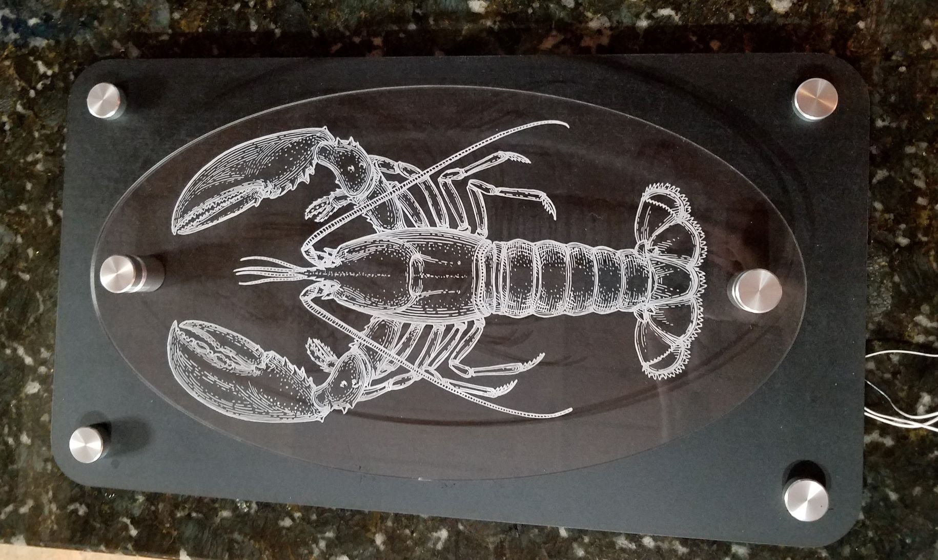

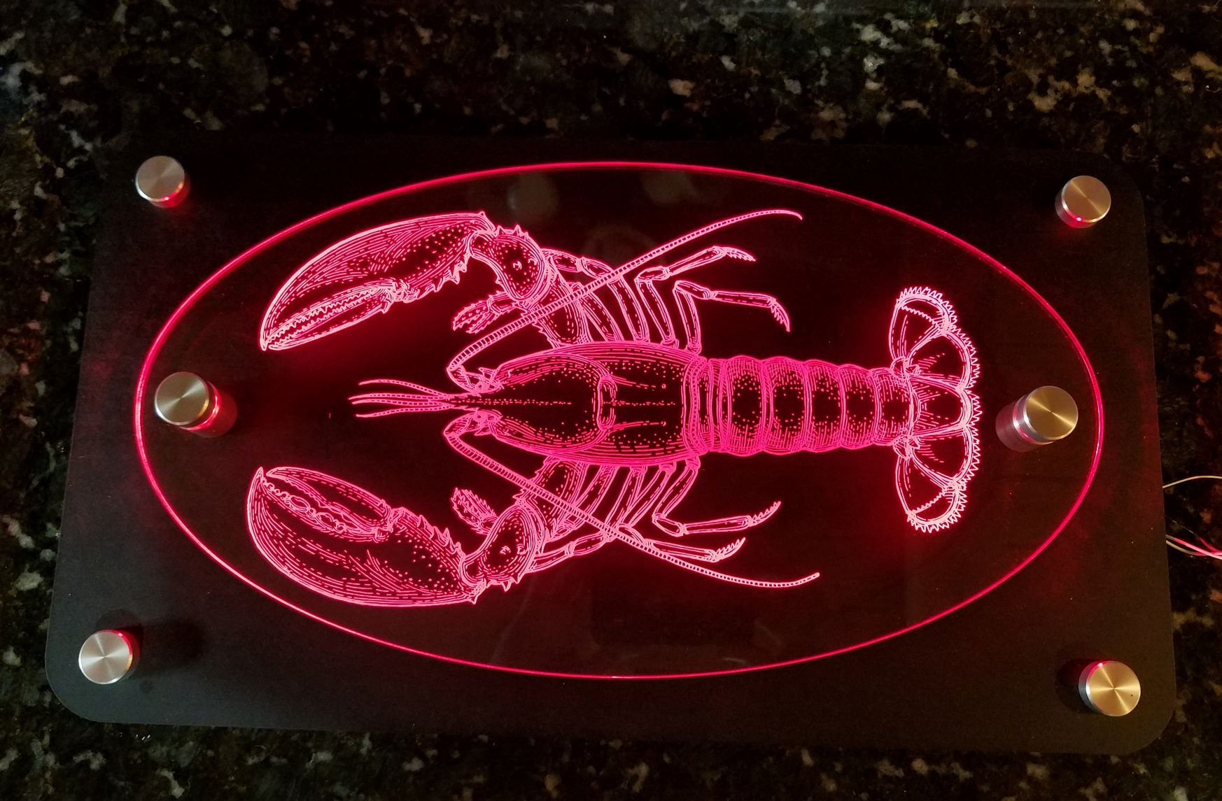

    First time using LED standoffs; these from Gyford. Very easy to use. The sign panel is laser etched on 1/4" acrylic then edge lit with side-firing LEDs that sit between the standoff barrel and cap on a disk. Backing board is 1/4" MDF sprayed matte black.
    This sign is heading to the new Pinkham's Seafood Market in Boothbay, Maine.

    Looks good, we use those for display in our shop, but we sandblasted our graphics.

    looks great! the ONLY issue I have is (and not that you asked) is the stand offs are too large and they are distracting and there is too many. other than that is rocks

    Great point. Probably with change the backer board to something with hidden hardware that still gives me room to accommodate the wiring between that board and the wall.
