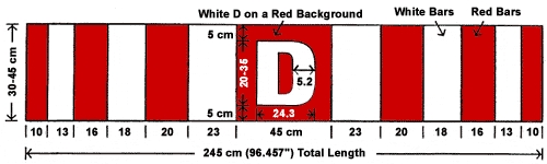

Purser
Over size load sign for Canada
Here is all I have to work with. I thought maybe someone might have made one.
