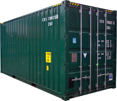

What would you guys use for lettering a shipping container???
I have a client that wants to do 300 containers lettering
Any idea?

just lettering, those 4 letters and the numbers on the container on the top right.
I assume cut vinyl will be just fine, but thats why I´m asking the gurus.
I dont know much more, even the guy who wants them dont know much about size, he only knows the letter-number combination, and the number of stickers he wants... what would you use?

Oracal 651 if it's white or black and doesn't need more than 5 years.
Oracal 751 if you never want to worry about any issues for 7 plus years
kanini
We've done a couple hundred of these containers and a manual that we got (which specifies how to make these markings, they are standardized) says you strictly HAVE to use cast material or paint, calendered is forbidden. I'd recommend you check with your client what material they want since there is regulations/standardizations for these markings and you don't want to redo/fail with your quote on this amount... Good luck!
