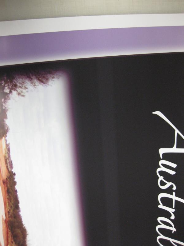

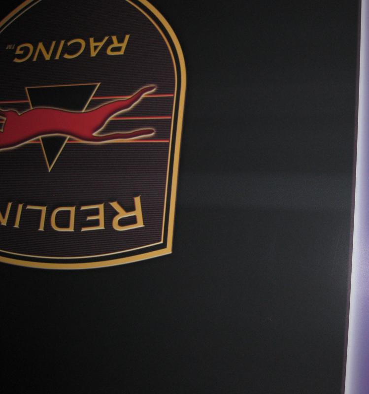

I have attached pictures of the following issue.
We run on a 54" Roland 545 SolJet, and use ecosolvent inks.
We are expierencing the issue in darker blues and blacks. Its a light band that randomly runs across the entire print. It is always about the same width in size (1").
We have tried a number of different service issue solutions and cant seem to find the solution.
Does anyone recognize the issue or have a possible solutions please help.
Thank you very much.

we have that issue periodically. still have not found a solution other than it does it sometimes and others it doesn't. One thing of note is that it seems to be 4 or 6 full passes every time. If we have it set to 4 pass, then it's 4 passes wide. Same with 6 passes. We have not had it as much while using the RIPC profiles.
Letterbox Mike
Is that in the scan width or the feed direction? If it's in the feed direction (perpendicular to the movement of the head) try cleaning your encoder strip.

I get similar results because my printer chokes sometimes. I think it has something to do with the information not getting to the printer fast enough. Every time the head stalls, I get a line depending on the media. I only notice this on huge files though. Still haven't figured it out.

I have an older 2004 SC-540. I see this band from time to time. When it starts to become more numerous, I do a full head alignment and bi-dir calibration and that seems to take care of it. From what I can tell, it's either from the pulley cable stretching over time or the slow wearing out of the scan motor making occasional passes become mis-aligned. I'm just about to the point where those items need to be replaced, but the head alignments are the only thing that has seemed to make this go away. But they eventually come back.

occationaly mine will do that and every time it does it is because the media has used up all of the slack from the roll to the printer...
am I saying that right...?
in other words...once loading the media I always unroll it down almost to the floor...but sometimes on a longer print if I am not paying attention the slack gets used up and the printer is forced to pull it from the roll causing that exact thing to happen...
