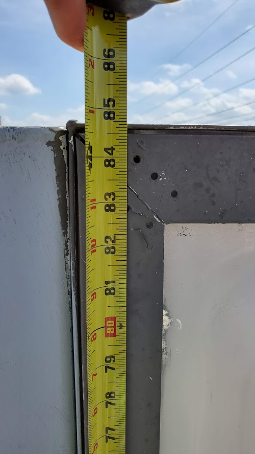

New business would like a quote for this lighted sign box. Box appears to be in good repair and lights work. I've done lettering on existing boxes but I have not replaced the substrate yet. I think this looks like a good project to tackle for me as a first timer. Size is approximately 9' x 22". Easily reached with a couple ladders.
1. What material would you recommend for the substrate?
2. Looks like the ends come off and I just slide the material in?
3. Logo colors are red and blue, American Flag type logo
Thank you!
Only use Polycarbonate, not acrylic. Acrylic will fade. For the vinyl you must use translucent vinyl. Yes if it's a standard cabinet, remove a retainer and slide out. The sign face must be about 3/8" shorter than the cabinet to fit. I recommend measuring the old sign face first.

Another helpful tip, take pictures of the measuring tape when you do this. Sometimes I write stuff down and can't read or understand what I wrote, or it's been 2 months since I surveyed and can't find the paper.

No way the UL inspector got a look at that sign before it left the shop. I would use plexiglas in this size cabinet. Much brighter in the long run. I cut 1/2" shy both directions to allow for plastic expansion if done in cold weather and 1/4- 3/8 if done in hot weather. Definitely remove an end retainer to get the face measurement since some extrusions are way thicker than others

You could do vinyl lettering(on clear) and look for white polycarb to apply that to. I would also split this job in half....easier to work with and plexi and poly come in standard 48 x 96 sheets usually and you will pay a lot of extra trying to get a 9 x 5 ft sheet just to take 9 in off the side.
