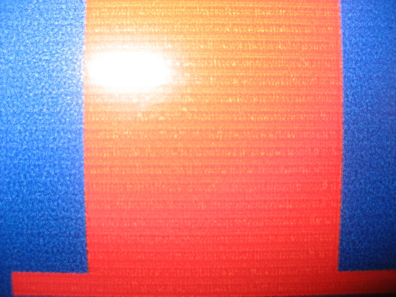

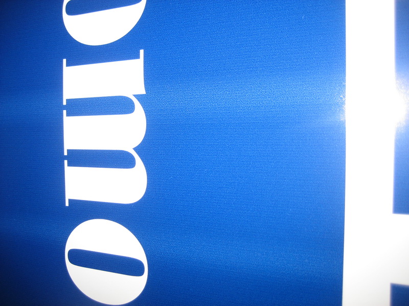

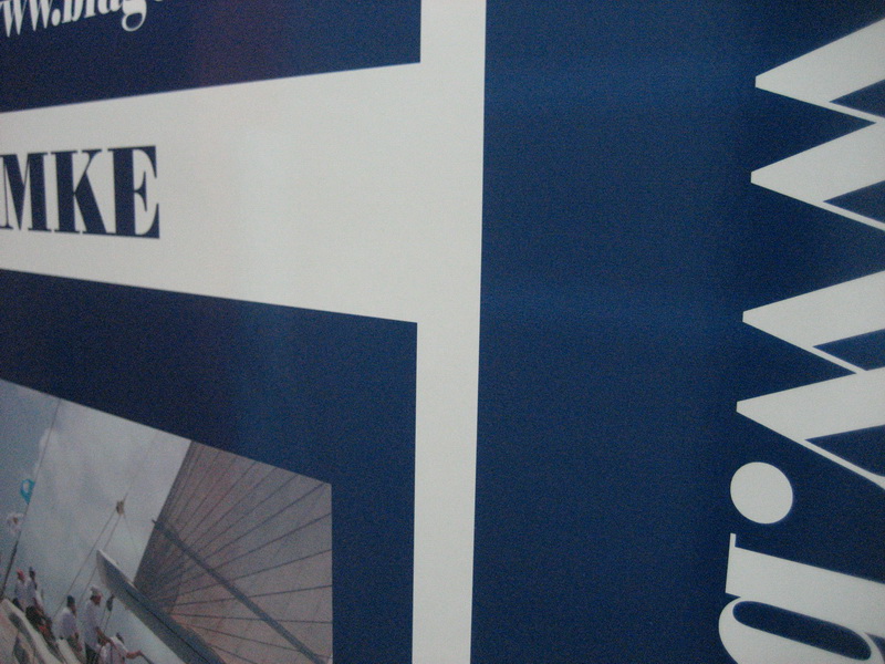

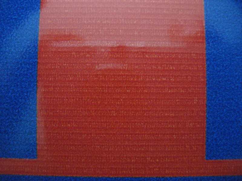

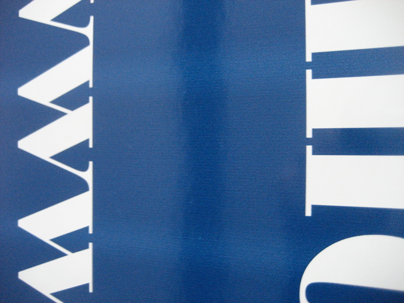

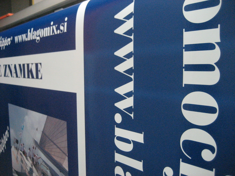

Hello!
Im printing some prints, and im having this problem...
first 4 picutres...
what couse that? does it have something to do with text on left? becouse where text "znamke" is there is ok...
and second problem...
last 2 pictures
colors arent so full as they should be! wrong profile???

dimitris34
i have the same problem
I have the same problem with you, white stripes every 5 cm in the way that printing heads print...
Specially in adhesive vinyl i see it. My machine is Rockhopper 2, (Falcon Outdoor II).
Recently change capping station,wipes etc my a mutoh tehncian. Also he did me and alingment of heads. So heads and nozzles are ok
Any help?
Because i have dead line for a job and i dont know what to do
Flame
It's because of your heaters guys. You need to go in, tear apart the printer, and where the heaters are put that silver/chrome lined tape (heat tape).... put in a couple layers of that and that should solve most of your problem. Not 100%, but it will almost eliminate it.
dimitris34
Thanks,so, the heat is too high? Why this problem happening?I do not had it in the past.
And what do u mean heat tape?
Also my machine makes a noise after changing pf motor.Its not from the motor.It seems to be from the rollers but i cannot find where exactly...
signage
Putting on metal heat tape helps spread the heat out across the print bed getting rid of hot spots!
The Big Squeegee
Long Time Member
On my rock hopper there were gaps between the plates where the heat strip is. By putting tape over the gaps it evened out the distribution of heat. One solution to the light areas is to turn the heat down some. Too much heat seems to make the vinyl open up the pours and pull the ink inside so that it looks lighter in some areas.
Trial and error on heat settings is the best way to solve the problem.

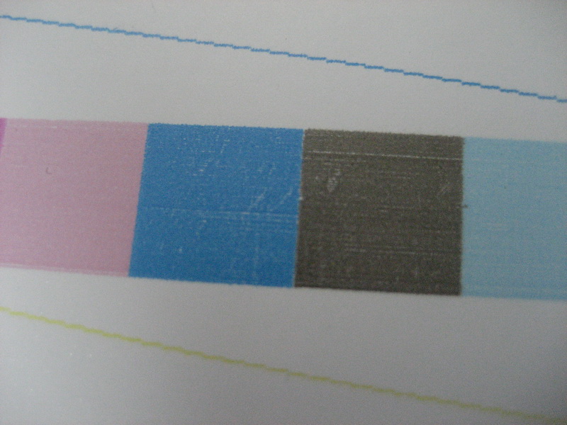

1.- What does the nozzle check look like ?
2- Looks to me like ink starvation
nozzle check is ok. i changed heads 1 month ago...
so u think there is something wrong with printer?
