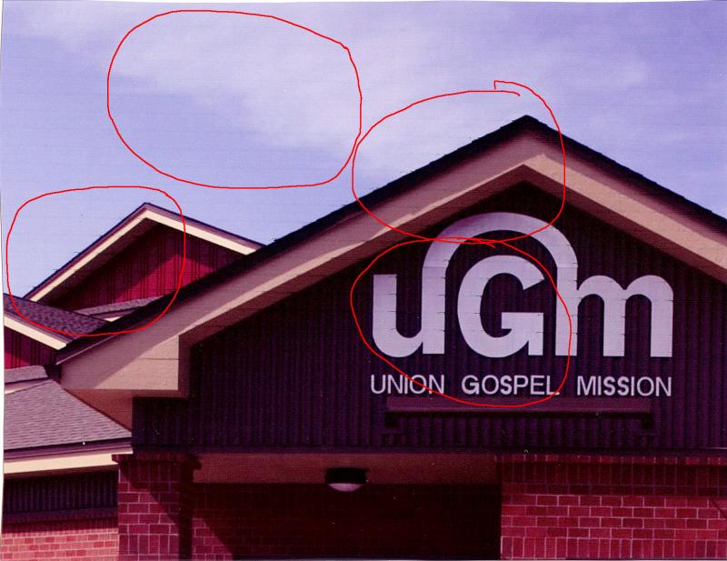

I am having the worst time with my VJ1614. I had a reoputable company put in a new print head and maintenance station about a year ago, and ever since then I have had intermittent white lines show up in my prints. It only happens on certain colors, and every now and then they show up along with what I can best describe as "drag marks". You can see in the attached picture what I mean. The lines do get better after a good thorough manual cleaning, like I do once a week, but they are nevertheless there. After I had printed this image, I ran a nozzle check and all of my nozzles were there. I should have had the company come back out within the warranty period for the print head, but it was so intermittent that I just lived with it. Needless to say I can't live with it anymore. Anyone have any thoughts?

At a glance it looks like you have some hair/fiber stuck to a print head dragging through fresh print.

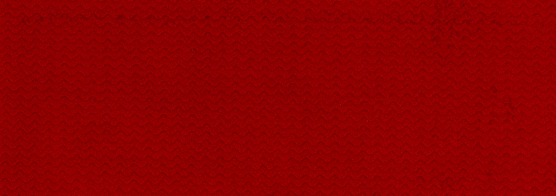

I agree that the drag lines were most likely a hair or dust on the head. However, it still does not account for the lines that are occurring in the prints. On a separate, but probably related issue, I have a noticeable wave pattern in my prints that I never had before. I just printed a red banner for a wrap job next week that I have printed before without issue. The last time I printed this exact same file, with the exact same print profile, was back in March. It looked fantastic back then, but this time it has very defined waves in it (see attached picture). If I haven't touched any calibration options on the printer or print profile settings, what can cause the lines and waves all of the sudden?

Ok it appears that the waves are uniform to the image. There is a darker tint evenly spaced. These would be what I would consider.
- is there any contaminant on the head or the carriage
- is the head or carriage touching the media when printing
- are the heads vertically level and sealing correctly on the capping station
- are the heads correctly aligned on the horizontal axis
- is there excess back pressure from say a bad ciss unit
- is there air in the lines
- has the correct head rank number been entered
- are the dampers sealed correctly
- is the wiper ok
To identify issues I perform a low quality output on household lining paper as this paper does not bleed much so you can see the issue easier, its also cheap and on a roll.
It could also be firmware / software based as the wave is formed from the i2 weaving technology so would appear to be there prior to the image being printed and could be a digital issue.

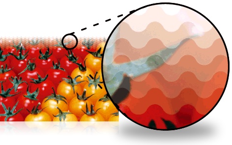

This is an example of the i2 weaving that goes on, I'm assuming this happens on all colours and that there is a problem with the spacing on these weaves when the printer advances for the next pass. Hopefully just a spacing setting that's been changed by accident.
It appears to be over printing and causing a darkened line where the ink is in essence printing twice. This could be software/firemare issue or the media not advancing enough (settings, worn rollers, media not moving freely enough...) and thus causing the over print. If there is an option to turn the "i2" off see if you get the same overlapping issue.

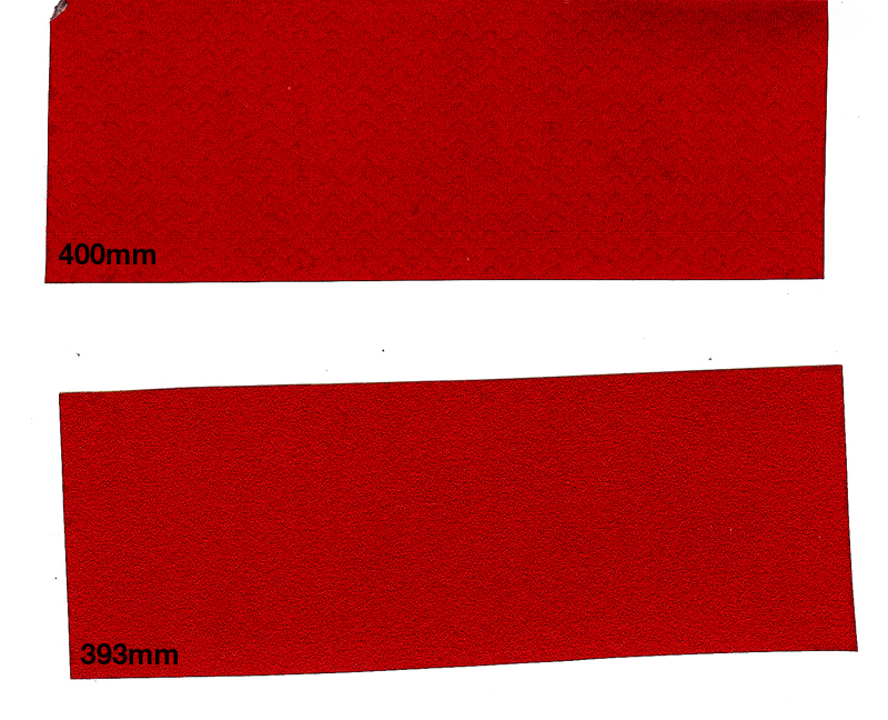

On a side note I ran the PF test at 400mm and it measured out at 399.5ish. I made the adjustment, but it made no difference in my print.
Correction: I had to adjust the PF all the way down to 393mm (7mm off of standard) to get it to print right. I've attached a pic.
