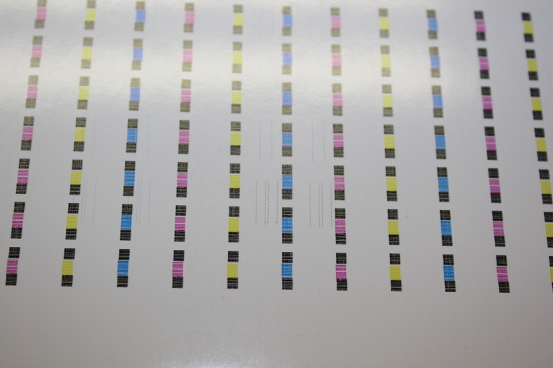

i use a Rock hopper 38.
Increasingly i am gettin small lines on all prints in the feed direction.
Originally in one place. Then 2. Now 3.
the lines seem to be in groups of 4 in a definite patten. Various lengths in the feed direction.
They do not line up with wipers or rollers.
They first appeared in black now red as well.
Any thoughs appreciated.
DK

DetailsGS
tried that no luck,
Its not a software issue because it does it on test prints.
You can see it here on an alignment test.
Its like an involutary pulse of the print head.
But its increasing and it does it in all colors.

Do the lines show in print files? If so could you post an image printed. The lines in the test print looks like blocked nozzles. Have you done a cleaning?
DetailsGS
Rockhopper and Falcon Jr are the same machine.
the lines show up in all prints. Originally the lines showed up in one spot along the print bed.
Now there are 4-6 sets of lines which are actually rows of tiny dots
along a 5" area of the print bed. Alway is the same location.
i have done a self clean and a soaking.
Is there a more extensive cleaning i can do?
Please explain how a blocked nozzil can leave a mark.
As that seem contrary to my logic.
i have read some suggestion of static or communcation interference.
How do i clean the encoder strip?

Mary Gotcher
I have a 46" machine Falcon Outdoor...we replaced the tfence ($150 ish at Sign Warehouse) and it fixed the problem. In the alternative you can remove it (be careful not to bend or crease it) and flip it over. It may buy you some time. I did have the same exact problem. Actually I was surprised that was what was causing it. Strange machines...
