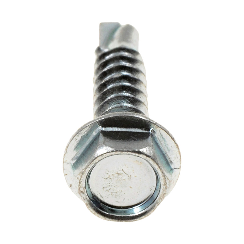

BINGO...........i erected many METAL BUILDING, now these are STEEL SHEETS, STEEL FRAME & AND STEEL SCREWS....... so no dissimilar metals involved. TORQUE on these(they last 20-30 years) and can be removed and replaced........USING THE SAME SCREW HOLES........SAME SCREW numerous times without any ENLARGEMENT OF HOLES!!!! so who ever is telling you this.......dont know SCREWS))))

the only way taking screws out and putting them back in messes up the original hole is that whoever put them back in went too fast on the drill. for years we have taken these things out and I always replace screws slowly and only remove a small ammount at a time while doing trailer
OldPaint
i forgot to say this: ONCE THE DRILL/SELF TAPPER MAKES THE HOLE........the THREADS OF THE SCREW WILL .......make the hole a little bigger.......yes.........and if you take the screw out.......the drill tip going back in has no metal to cut as the hole is bigger(just a tad) then the drill tip. and as others have said...........is people not knowing when to stop TIGHTENING the screw........thus it STRIPS THE HOLE OUT)))

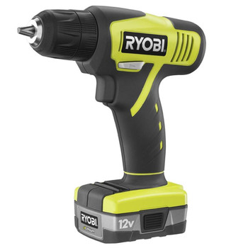

WHEN YOU STRIP A SCREW.........replace it with the next size up))))(#6, #8, #10 or #12) simple)))) and most of these trailers the inside is accessible if need be you can replace the scew with a nut n bolt))) but a lot of people have no mechanical aptitude...........i love my wife........and she is one of those.......i have to set the drill/screw drill clutch at less then tight......... when she uses it cause she cant seem to release the trigger when the screw is as tight as it needs to be......and she can strip the heads......for some reason she cant hold the drill/screw drill perfectly straight....she thinks it dont matter)))) this is hers...12V will twist your wrist)))
