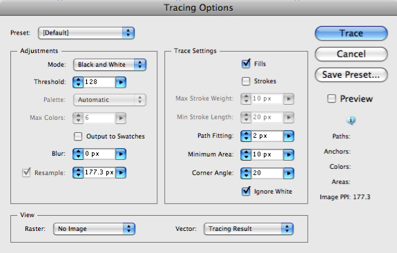

  10. The Vector Doctor
    The Vector Doctor Very Active Member
    3,496
    144
    63
    Aug 15, 2005
    Ohio
    The easy way is to click on "ignore white" in the lower right. Check that and it gets rid of the duplicate shapes.
