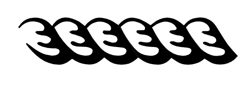

...or start with this.....
The Vector Doctor
Chief Bezier Manipulator
to shorten the attached video, I already drew one rope segment and added in the guidelines that represented the outer portion of the rope border. The center guidelines are to ensure that the shapes all rotated around a central point. Not shown here is the original jpeg in the background that I traced (no longer have original); the rope border had 50 segments 360/50 = 7.2 which is the number I punched in on the rotate command
