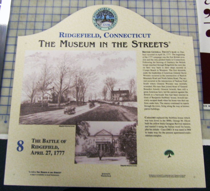

I have a quote to do for the local historical society furnishing 2' by 2' metal signs with digital printing. Their main concern is longevity and want them to last at least 15 years. (Of course they want a guarantee).
What is the best one can expect with digital printing on hp vinyl with laminate? The sample brought in was from an east coast company that specializes in this. I don't know if this is printed directly or even another type process. See sample pic.

I would not chase this as more than likely that is a porcelain sign. You will not be able to touch the longevity/quality of a porcelain sign with a digital print no matter what vinyl/laminate combo you use. Porcelain is a glass ink that is printed onto steel and then baked in an oven. Very heavy duty and will last a life time.

Thanks for all the suggestions. I called Gemini, no color for their plaques.
Rick, I am getting a quote from KVO for the hpl prints as he said porcelain would run over $400 sq. ft. I believe.
