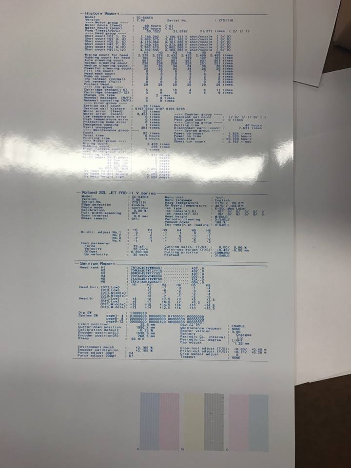

Hello i am new to the forum...... i have a screen printing / vinyl signage shop we have been looking to get into the digital printing due to the amount of banners we do a month. The ol vinyl cutter is becoming to time consuming for a 1 man show.
so i have been seeking the used market for a Roland print cut machine i came across this SC545 ex solvent printer and just looking for some incite on it.. its running on bulk ink with a take-up reel it seems to have really low hours for being 12 years old 7xx some scan hours 1300 printing time with 22,000 hours spent in sleep mode.
The print test looks fairly good seem all heads are under expected life i have a history report ill attache i have around an 8,000 budget should i keep looking or move on this one ?
Thanks for any input in advance

If you have good credit, use the $8000 as a down payment and get a new printer. You would only need to finance around $2,000 - $4000 and the machine would be brand new with a warranty!
The machine is decent but old. Six heads means a lot of head aches, no pun intended. Heads are expensive and on older machines it's only a matter of time before they fail and it means big bucks to fix. The machine is slow and the quality is not so great but I am mostly comparing it to today's standards. When they came out, they were top of the line.
You actually have a decent budget compared to most people who come on here asking for advice. Use it to get a new machine or at least go look for a well taken care of Mutoh ValueJet, Mimaki JV33 or Roland SP540V. Each of those machine blow the SC545EX out of the water and you should be able to find 54" versions of them used for well within your budget. .

Used to run one. Great printer, required minor daily upkeep (manual head cleaning/ink station cleaning/etc). But traded it in for our 2nd HP Latex and realized how much time even that little maintenance took. I would seriously invest in new tech, a new printer, instead of buying a 10-12 year old machine, that may run fine, but limits you in many ways. Eco-sol still requires 24 drying time before lamination (I know, I know....we laminated stuff right off the printer too - not recommended). Latex is ready to go off the printer, even more so with the 5XX series.
