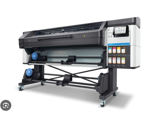

Hello everyone!
I have a very small "Home Based" business at 859 Huber Dr, Port Coquitlam, Canada - http://quartercheapersigns.ca/ .
I work on an HP Latex 700 W printer.
Unfortunately, from time to time (once every 3-6 months) the printer breaks down unpredictably - and then hell begins.
Like right now - it's been 4 days since the breakdown - but the supplier can't even give an approximate date when a service engineer can arrive at my location with the necessary spare parts. And I'm losing money and customers during this time...
If you are in a similar situation - we could help each other! For example, indicate the cost of printing for such cases - I could print for you in emergency situations, and you can print for me.. For example, there seems to be a function for calculating the cost of printing in accordance with the amount of ink used.
I can work at night and on weekends - if you need my help urgently :)
I also have my own boomlift - I can also be useful.
Thank you all very much in advance :)

Various parts broke.
Last time - the vinyl feed motor.
This time - something with the drop sensor - already the second time...

Last time the vinyl winder motor burned out. This time it says the drip sensor is not working.
Frankly speaking, I don't think that fixing a burned out motor is something I can do quickly and well. :) And the most important thing is that I won't break anything else in the process.

Make sure they fix it proper now. I can promise you have this issue on your machine or had it in the past if you say you had problems with it 3 times.
They need to fix this cable good or replace it but it's part of the service station that drop detector connects to.
This is why I say you should consider fixing it yourself if you have some technical skills. Could have probably had it fix it in one day. Of course it's possible that the DD has a real problem as well. I've only seen it once, the gear broke off and then there's no other way than to replace it.
One of these cables always break at this point and give you DD problems.

Is that wire just vibrating against the cable tie sleeve until it's cut or breaks?
Difficult to say. But this cable always moves when the DD moves. So is it an assembly issue at the factory or the constant movement, I don't know.
Now if I touch it I will leave this cable further out and not use cable tie. There's plenty of cable and space to move around for that small movement.

a piece of heat shrink, or this would help
