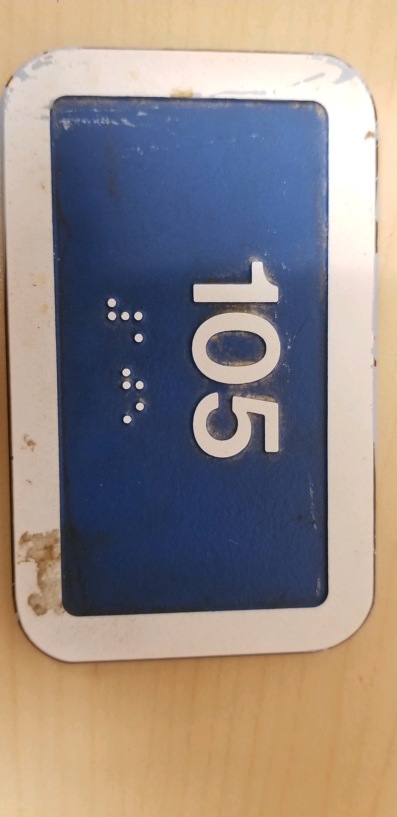

They don't know that - they gave me a picture of what they have currently and want a price to replace some - if the price is right they will replace ALL of them in the building. This is what they gave me... not my usual type of item

That looks like CNC into a piece of White/Blue Plastic or Acrylic.
FYI: you need to check that braille closely, to make sure the current signs are compliant with ADA.
703.3 Braille. Braille shall be contracted (Grade 2) and shall comply with 703.3 and 703.4.

That is correct - these would be Grade 2 - which thankfully for number signs are simple as there are no contraction symbols for numbers - they are 1 to 1 use with a # in front
