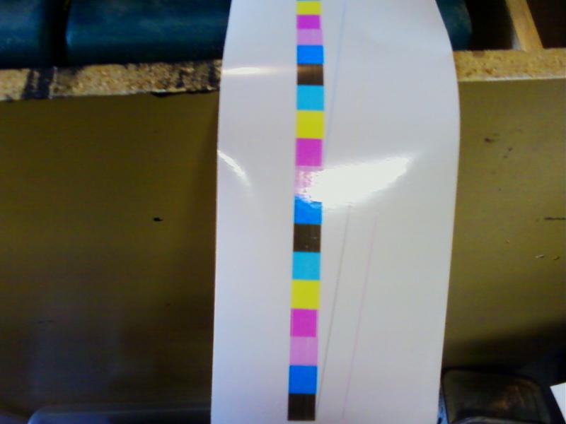

Ok guys, with a lot of help here, and a ton of help from Victor at cmyk parts my nozzle check finally is looking pretty good... should I keep trying to get it clearer, or does this look like its time to just start printing?
I guess heads that sit for over a month are still usable with some patients!

Still looks like you are missing some black nozzles at one end and a bunch of magenta.
This will make for some pretty prominant banding. Which may not give you saleable prints.

Mostly head soaking and pulling ink through from the wast station.
But do you think it will help clear them up to start printing some no-essential prints...? or will it not help clear those nozzles up?

sometimes, it helps.
Pretty unusual though in a situation like yours.
Even if you print, I would do some long head soaks, rewetting every 15-30 minutes then pulling with a syringe. You have to soften up those plugs enough to get them removed.
