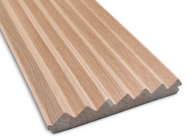

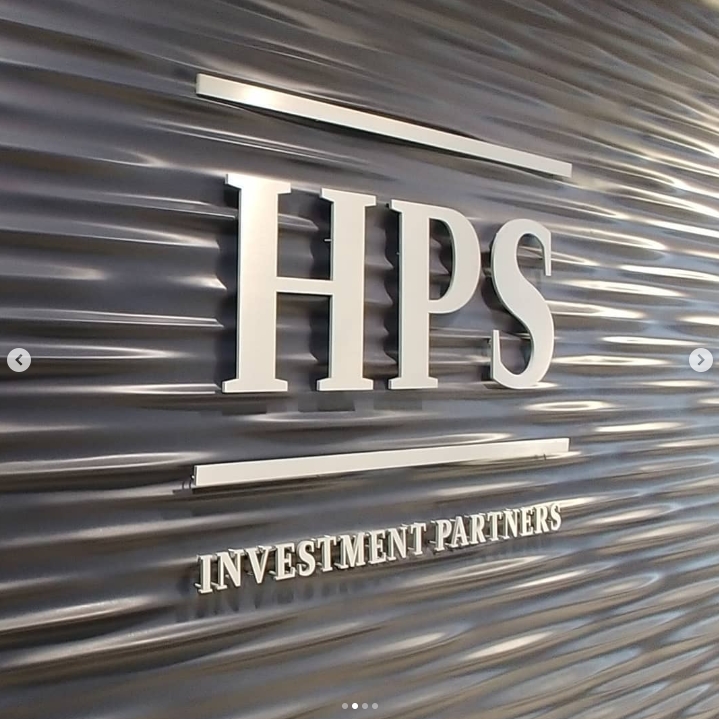

We have been asked to install letters on this type of interior wall panel. It looks like corrugated wood running vertically on the wall. The "peaks and valleys" are about 1" wide. The size of the letters vary from about 6" to 2" high. There are a lot of letters. I don't think a clear acrylic panel with the letters on it will look good. I like a challenge, but this one looks a bit too much. :eek: Any suggestions?
SignBoi
Hey Jean, I would think installing an clear backer (acrylic or polycarb) -Attached to the peaks of the wall would be a solution. I've done something similar with a slatted wall (acoustic dampening material in between each slat.)
I routed a clear piece of acrylic that was a 1/4" smaller than my font so that it was mostly hidden except between letters and gaps between words. It was also used as the template for installing the routed letters as well.
I predrilled the acrylic, screwed it into the high spots then used vhb and a couple of dabs of silicone to adhere the text.
I also made and brought a version of the clear acrylic backer that was 2" larger than my font to have a clear border around the text that was intentional looking - in case the client preferred that look. They chose option 1.
Good luck

If that was metal it would be a PITA but I'm thinking with the wood you can drill straight and would be much easier... especially if it's only 1" O.C. Metal you have to hit at an angle and then straighten the bit.
visual800
i think what would workk good on this install would be to cut a pattern out of .25" pvc and tape that on the wall and that way it would "hold" the letters while silicone set up!

They're honestly not hard, you just need some patience. Tape the pattern up, use a long reach marker or Pica type pencil to mark your holes on the wall, then drill. The nice thing about wood is that even if you mark/drill a hole slightly off, you can tweak the letter enough to get it where it needs to be. Keep your sawdust in case you need to wallow out a hole. Add some silicone and cover it with the sawdust.
