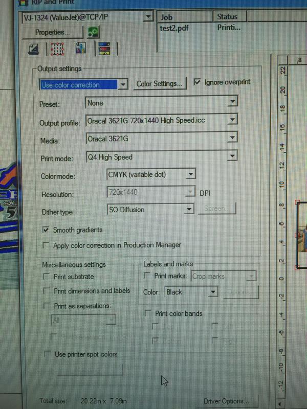

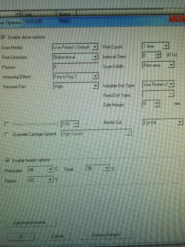

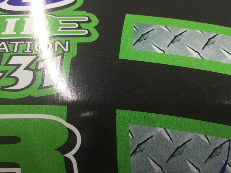

As of now we have put the new machine on hold. New dampers, flushed head, new encoder, new o-rings on all lines, and we are up and running. Now if i could just get the colors to not look muted but again that may be me since i have never used a digital printer before. Testing with Oracal 3165 and the same on the icc profile. Black for one look light to me.
Attaching a image but it may be hard to tell. K is at 100% on the color setting.
