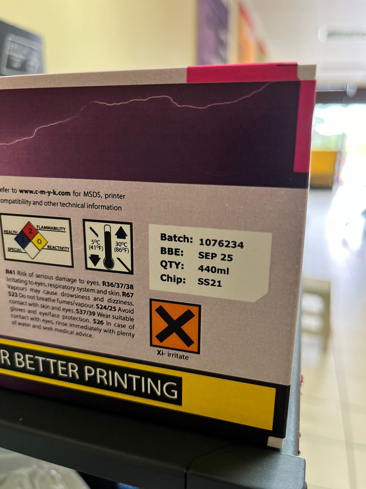

Ok, im going to take it out and put in a bowl and suck from the top. Has anyone used acetone? is it too abrasive? or can I give it it a go. I spoke to the company where I purchased the head (in Germany, so its I cant just drive over and have them take a look..) and they seem to think the magenta ink is the problem, since all the other lines are clean. My ink supplier is not answering my emails... the head has literally printing 3 weeks now, I am devastated.
Neil
Don't use acetone. Use only the same cleaning fluid as the ink.
Which ink is it? Refillable bulk or sealed cartridges?

The ink only expires in SEPT 25 and I have been using the same ink I have never changed to a different brand. Its Bordeaux solvent ink
