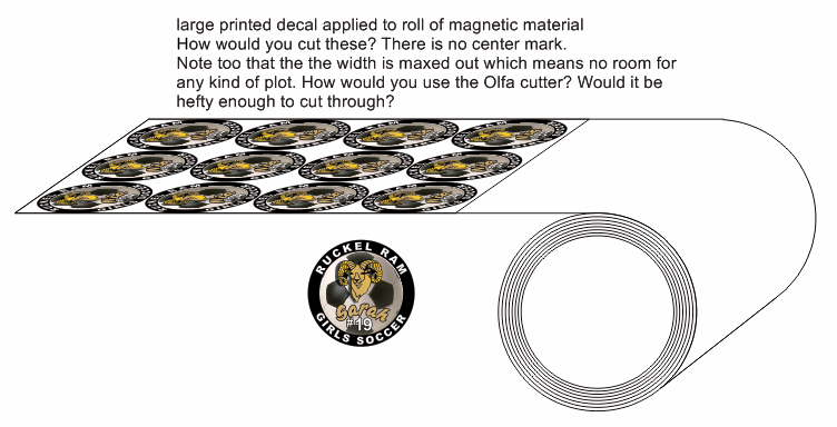

Where did you get the impression that the center point is already known? As you see in the youtube video she is cutting from a random start point. The magnets we have DO NOT AND CANNOT HAVE A PRINTED CENTER POINT!

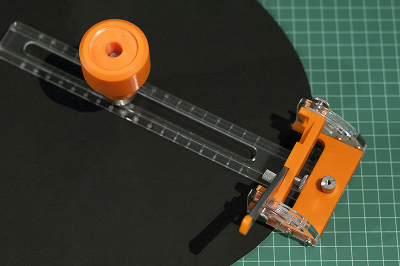

Here you go
1.Cut a circle the same diameter as your magnets design
2.Find the center with a tape measure
3.Mark center with pencil
4.Place that circle over your design
5.Use Olfa or similar circle cutting tool like attached
Repeat steps 4-5 as many times as needed.

While you do that let me cut one by hand. By hand is still faster. Why not have a four way ruler on the cutter instead of the one (again see the example in my first post)? This would allow one to quickly center it over the mag.
Brian27
You're telling me it takes longer to place a circle on top of another circle and cut it in the same way your "design" does vs. perfectly lining up a four pointed ruler that doesn't even exist?
You came here supposedly looking for a solution for your problem, and many people offered good input and suggestions, yet all you've done is tell people why their solution isn't as good as your fictitious circle cutting contraption.
Print one design with a red dot in the center. Cut it out. Place ontop of the others to find center. It REALLY does not get any more simple than that.

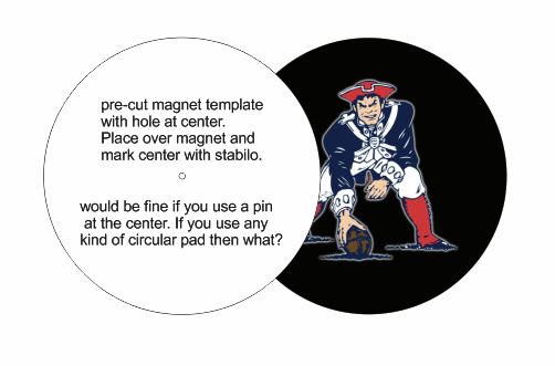

Brian, calm down. lol I'm trying to follow you the best I can. Bare with me in this journey. How about this scenario. Any thoughts?
attachment.php
Brian27
Haha fair enough.
What do you mean by use a circular pad?
You really don't even need a hole in the template, just a printed dot would be fine. The template would stay on top of the part you're cutting while you cut it and it should stay since it's magnetic. In theory anyways.

Holy crap! The light bulb just came on! Easy on me though, I'm an old man. And kind of slow sometimes. Yes, that makes perfectly good sense now! I shall entertain the idea. Thank you all for your patience.

Not necessarily. If you're printing 25 custom sized magnets for 'So and so' just print an extra one with a red dot in the center and it becomes your template for that order/specific size. Hand cutting 1 seems better than 25.
