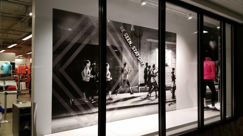

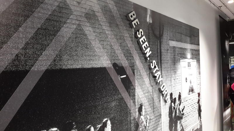

Believe it or not the method is very versatile and there is no risk of pulling paint (phototex will pull paint if they don't do a good job mudding and painting). Here is a magnetic receptive print with magnetic reflective overlays and magnetic dimensional lettering. No holes, no adhesive. The magnetics are over ferrous paint.
