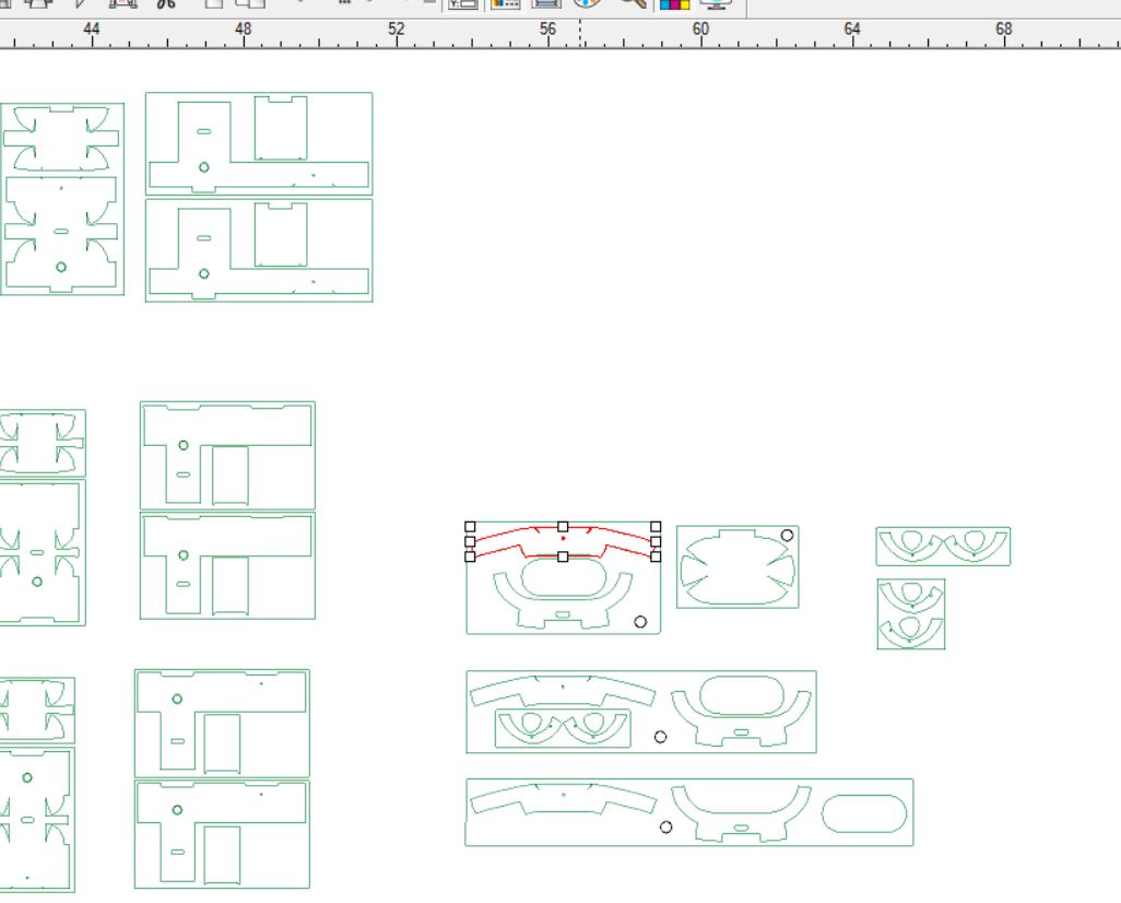

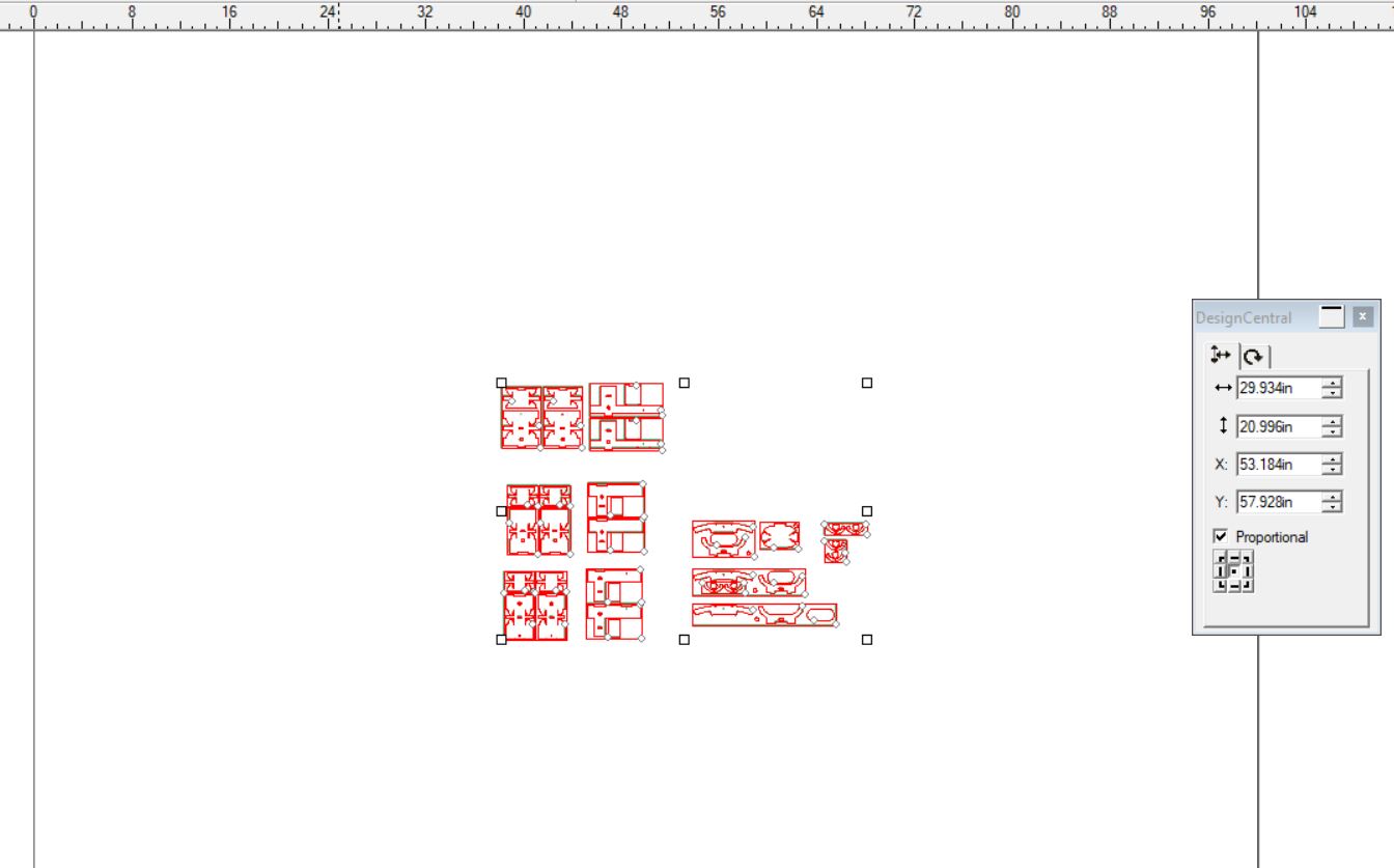

    We are trying to open/import an illustrator file with around 50 individual artworks into Flexi but Flexi would place all of them only as a single group (check the attached image After importing.jpg) and then when we ungroup, it ungroups everything (check attached image After_ungrouping.jpg). We have to group every single artwork again. That's a real PITA as we have more than 3000 of such artworks. All our artworks are in illustrator .ai. and we are using Flexi only for nesting since we have tried various nesting plugins but they are not as good as Flexi in the nesting calculations for our purpose.
    Anyway to import or open the artworks in Flexi, grouped exactly as they were in illustrator?

    Are they grouped like you want them in Illustrator first? And when you import, do you use UNGROUP or UNGROUP ALL?
    EDIT: Found you a workaround after testing this myself, each one of those grouped sets you have, you need to make them Compound Paths. They'll stay together once you ungroup them in Flexi.

    Used the Ungroup option. That would still keep the actual artwork grouped but the bounding boxes ungrouped. We have to select each artwork and group it again. Will try compound path but I remember it didn't work last time we tried. Will try again. Thanks eahicks for the tip.
