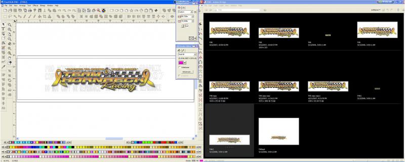

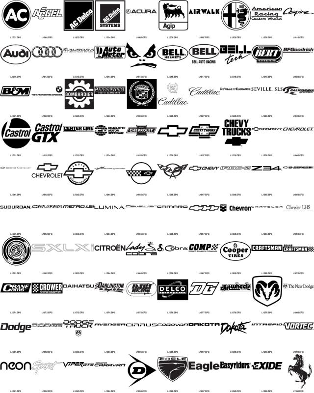

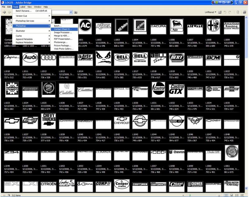

    I use Adobe Bridge and it reads my Flexi files no problem ,i open a folder then go to Tools then to PhotoShop then to Contact Sheet and let it do its magic .

    PMG,
    How do you get Adobe Bridge to recognize .fs files? The extension doesn't show as acceptable in any of the help files and it sure doesn't read them.

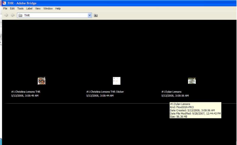

    Guys not sure what to say as you say it wont read Flexi files,,well im here to say that it does read mine as i see the preview of the file within Adobe Bridge.
