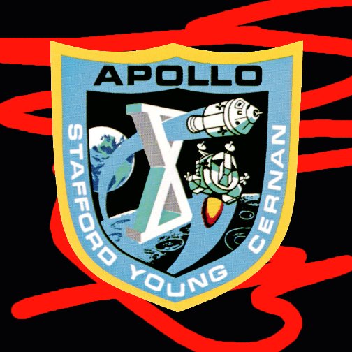

I have a high resolution .jpeg with a white background. I want to create a countour around the 'meat' of the .jpeg so that it can be taken and placed onto design that will be printed 'wrap' style. Is this possible? How do I do it?
I've attached an example of what I need to do>>>
Is this even possible?
Thanks!

I would do it in photoshop and make an alpha layer, then save as tiff and reimport into corel...google removing background with photoshop for help on how (I know it can be done in photopaint as well, just not as fluent with that program, so it's not my "go-to")

The image is going to be printed on the black background as shown in attached image. So I need to cut the white background out, so that its a clean cut around the logo and the black shows.

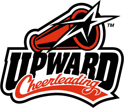

If you have a vector already, forget photoshop. Take the outermost shape. You may have select several shapes that make up the outermost shapes. Do a contour of those shapes and weld/join paths so that you have a single contour shape. the size of the contour will be determined by how much of an "outline" you add
The Vector Doctor
Chief Bezier Manipulator
see attached sample. The outermost shape (black in this case) can be added by simply doing a contour. No need to redraw it

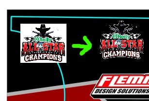

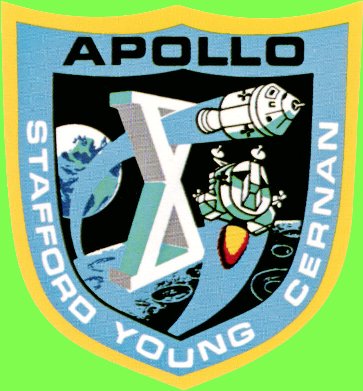

I will try to explain this better...
Image 1: .jpeg with green background
Want to take Image 1, remove green background in Draw, so that it can next be placed on black/red background and printed as shown in Image 2.
Thanks!!! Appreciate the help!

Thanks again for your help everyone. And I don't want to come across 'wrong' here...
I understand how to trace the items and make it vector, but that is not what I am trying to do. Lets assume that I have a super high resolution .jpeg logo that all I want to do is crop the background out of in Corel, and place the now background-less .jpeg ontop of other vector objects/designs in corel, so that the ENTIRE THING can be printed in one pass, as one big piece of vinyl.
Hope that explained things better?
