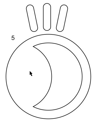

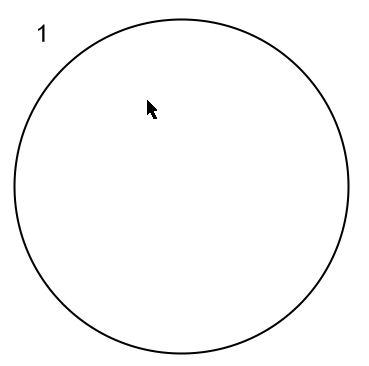

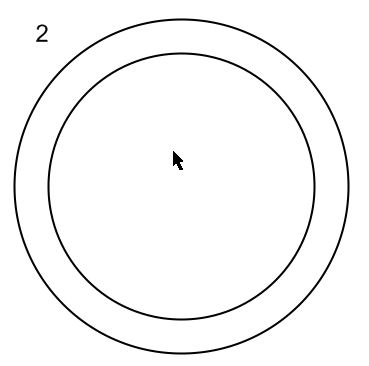

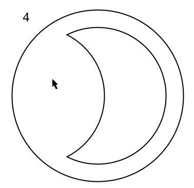

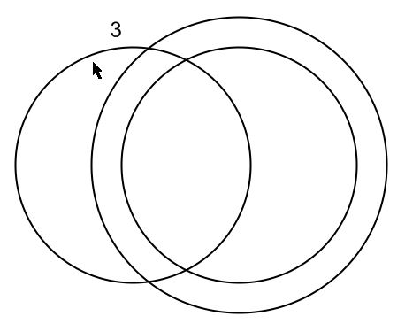

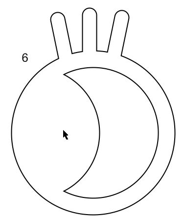

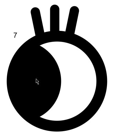

    maybe these will help... I work with corel, but the steps will be similar,
    1 - a circle
    2 - duplicate to the inside, smaller
    3 - duplicate smaller circle offset from original
    4 - trim (the corel command - flexi command may be "cut out"?) the inner circle from the last duplicate - delete last duplicate
    5 - draw a rectangle with rounded corners - duplicate twice - rotate two outer ones slightly
    6 - move rectangles over outer circle, weld rectangles and circle
    7 - add color
