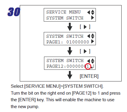

    I've ordered all the parts to convert my SP-540V from the old style ink pump to the new one. I'd like to know if anyone has access to the manual, or can give directions on what needs to be changed in the settings to slow the pump once converted.

    when i converted my pro11 i think the instructions came with the mounting kit, pumps bought separately its a one digit change deep in service menu, i will see what i can find.

    Thanks Mate, I've not received any of the parts yet, so it will most likely have instructions with it. I do know you're supposed to change the 12th 0 to a 1 or something along those lines.

    I received the conversion kit this morning, it doesn't come with instructions or a manual. I've reached out to the supplier but with different time zones there may be a bit of a wait.
    If anyone has either handy or is able to advise what needs to be changed in the service menu it'd be awesome.

    Just in case anyone else wants to upgrade and do it themselves; You need to change the 8th bit on the 12th page to a 1. There was a noticeable reduction in the ink pumped through to the waste bottle once this was done.
