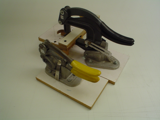

Roper-Whitney also has these neato bases for their punches- so that you
can fabricate your own jigs to aid production- I have only been able to
buy them from R-W and they are kinda expensive (like their punches)
but worth it (like their punches). I also have some of the cheepo punches
and some fit the R-W bases.

B Snyder
Somebody has a similar item on ebay...
