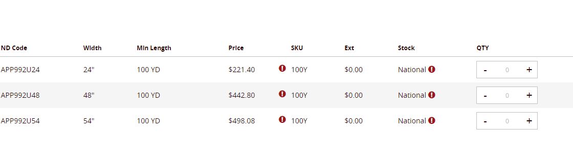

Thanks so much for the info, I will look into that 992U, and hopefully it's more reasonable than the other. Wouldn't mind, but I really don't need a whole roll of it for the price.
Chuck Taylor

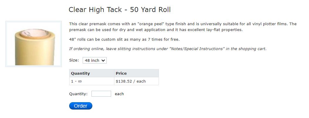

Just went onto ND's site, and... holy... but I did find something on TCT's site that looks promising. I always like to use the right material for the job, but I'd need 48", and didn't factor in the additional for mask. Live and learn, hey!
