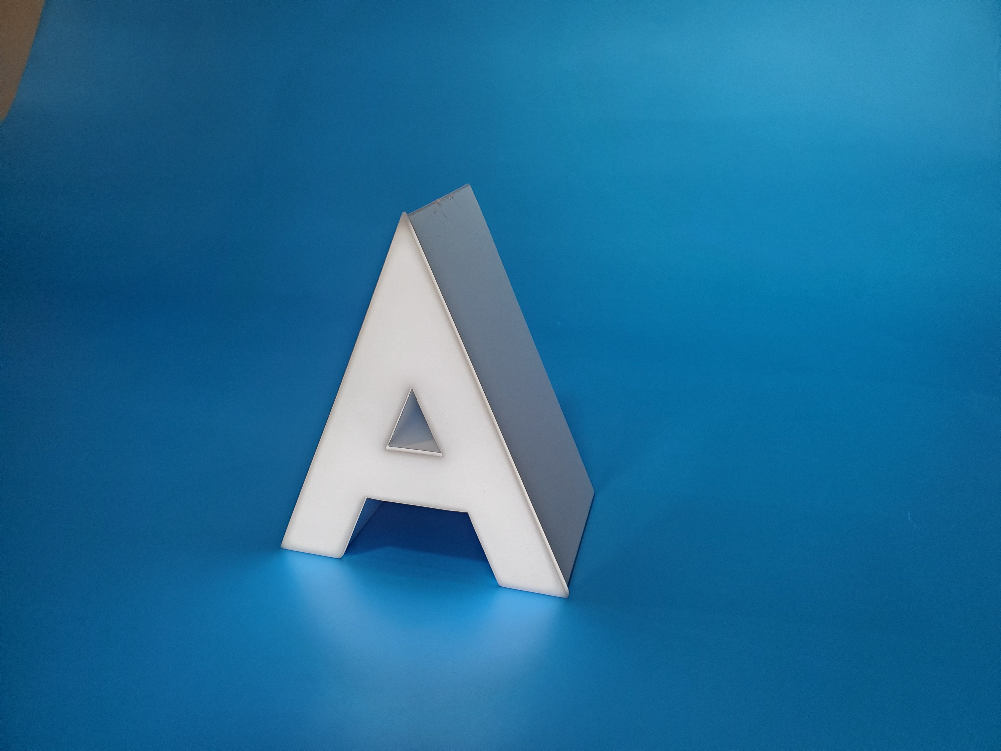

    As if making a trimless channel letter wasnt already challenging enough, I have clients that request that the lip of a trimless channel letter not be edge lit but that the return color is seamless with vinyl face. Usually there is a small lip that will light up white from the side. My solution is to mask the vinyl, chamfer the edge, and paint return and chamfered edge of acrylic right up to the vinyl. The problem is that my masking seems to either bleed or leave a residue on vinyl. Oramask is working okay but i hope to find something that doesnt bleed nor leave adhesive behind on vinyl. 20190926_150701.jpg

    I forgot about Gerber mask, but I've only used that on a non angled orientation (flat graphic stencils), and I think that is the real issue at hand. I'd almost recommend instead of camming the edges and painting them, cut your vinyl 1/16" smaller than your face, and then plot mask 1/8" smaller than the face. This way when your remove the mask you have paint over the edges of the vinyl. It does diminish the effect, the cam looks sharp, but since you are shooting at a 45deg angle to your mask, you're going to fill the void at the edge of the letter.
    Just a thought, are these laying face up or face down when you shoot them?

    Do you use the blue or olive 810s paint mask from oracal? I really appreciate the comments. I think my paint job might be too hot and heavy. I need to make the chamfered part of acrylic opaque and it requires a thicker coat. I might need to do a thin coat of a color that is more opaque first and that would probably help.

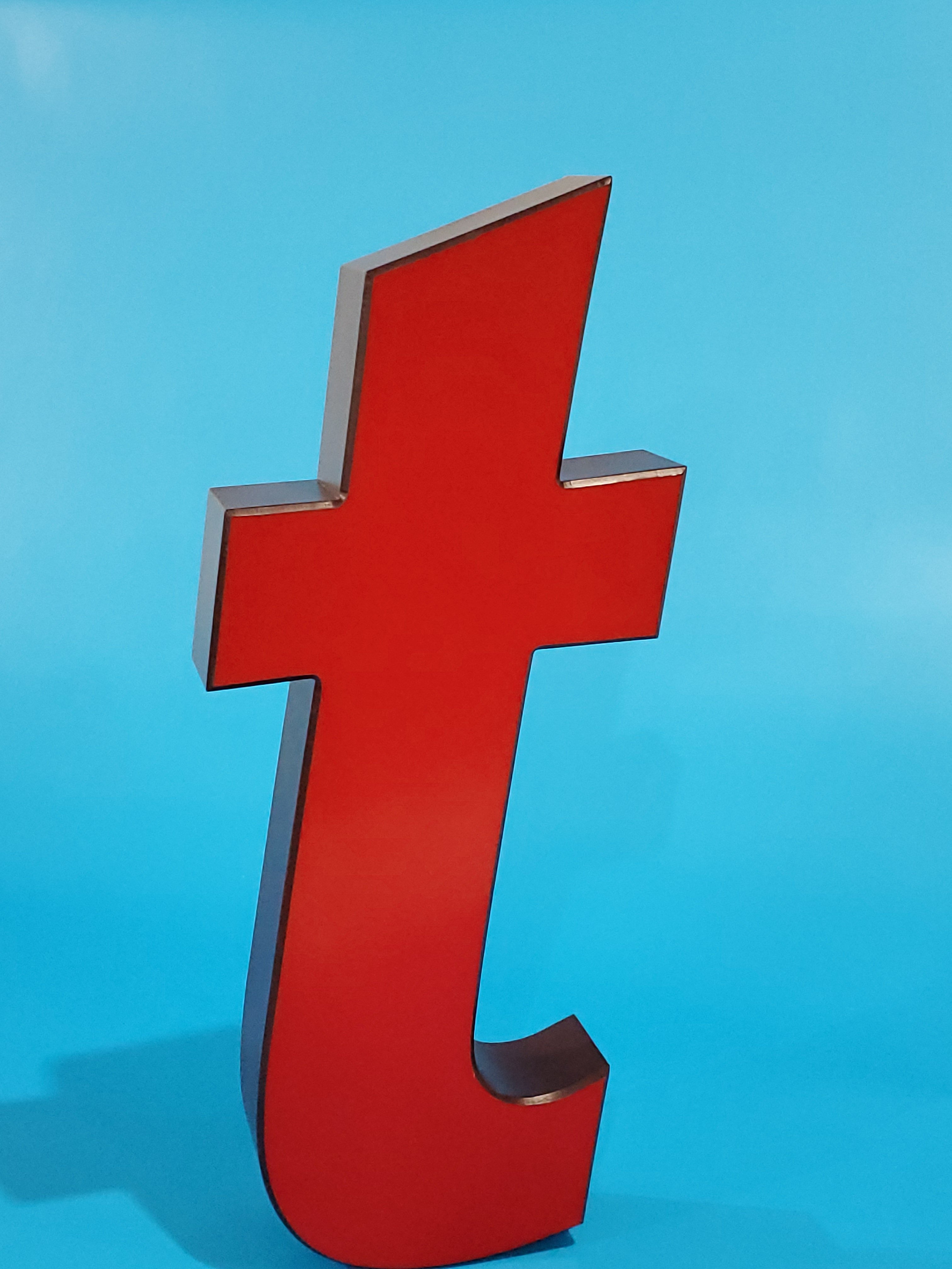

    20190926_130937.jpg thanks for the compliment. I can do a basic trimless channel letters like this 6 in. Letter A in prefinished white with acrylic face for $100 min. or $12 and upright inch for the time being so dont be afraid to send me a quote request. We are a small company and cant handle too much work. Just had to turn down a higher end job for 300 letters cause they needed it done in 2 weeks. Kind of sucks but as much as i wanted the job i couldn't in good conscious pretend i could get it done that fast.
