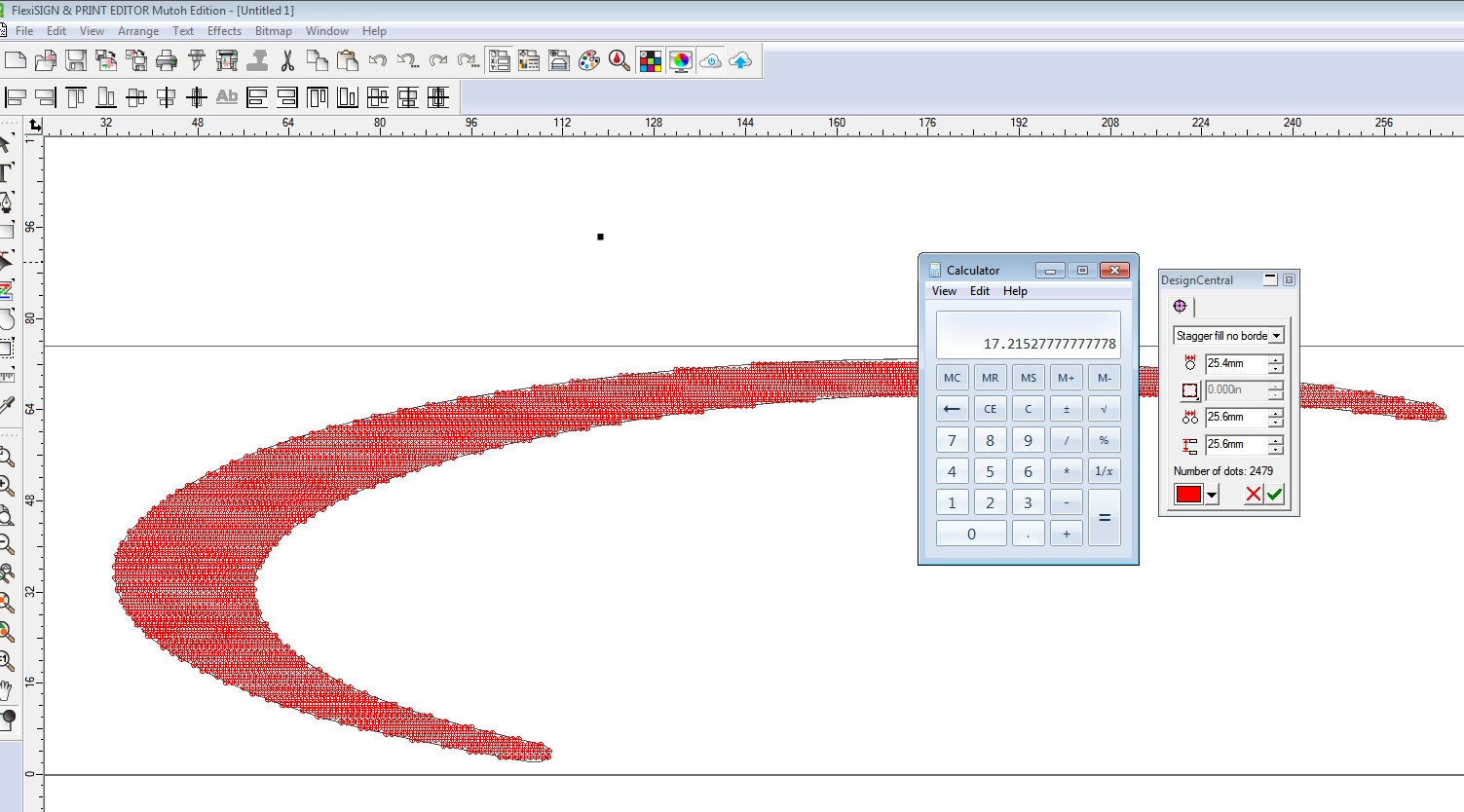

But I did find a unit of measurement you can use to prove your Burton Brute Force numbers to the building permit inspector, Texas style, using Flexi and the Glen Campbell option.
2,479 1-inch rhinestones works out to 17.2 sqft.

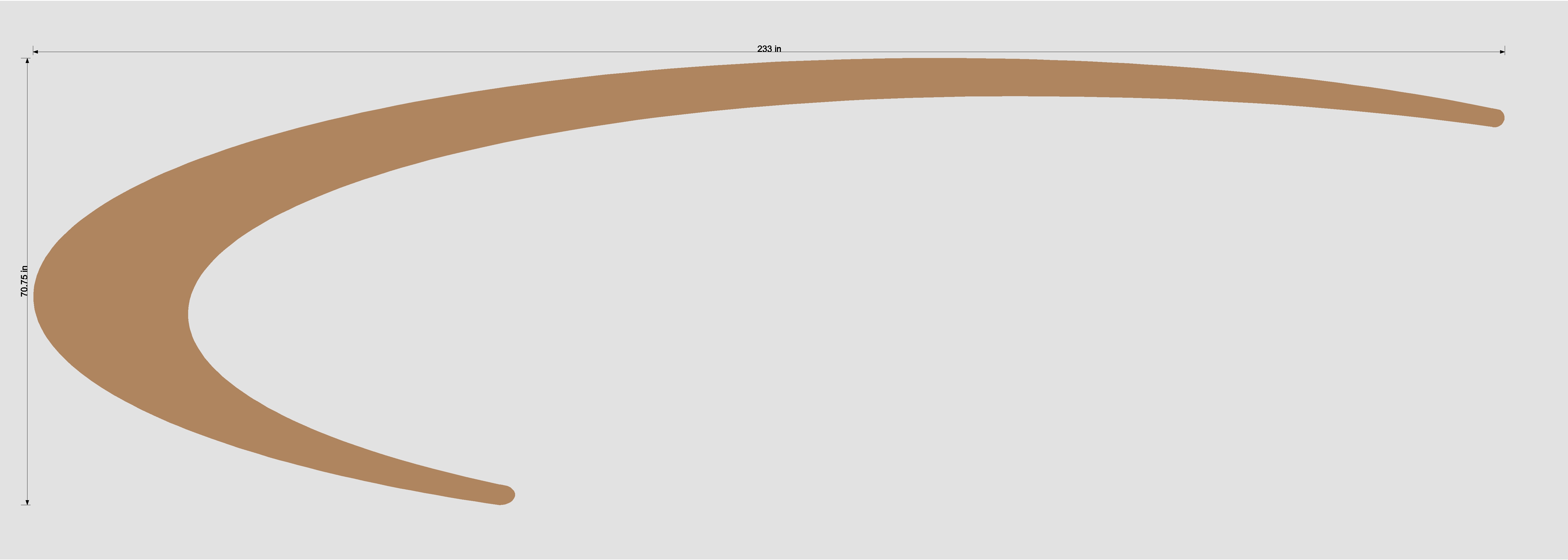

FWIW, I tried the 'grid of 1" squares' method JBurton suggested and got 2,209 full squares inside the swoosh.
I also got 709 squares that were along the border of the swoosh, and if we assume that these are around 50% of a full square on average, then we have to add 354.5 square inches to 2,209.
This equals 17.80 square feet.
To double check I repeated but nudged the swoosh a little on the grid.
Then I got 2,219 + 710 squares, which resulted in 17.875 square feet.
So I estimate it to be between 17.8 and 17.9 square feet.

I have a logo in the shape of a swoosh that I'm trying to permit. The city says I don't have to use the over all dims and can use only the actual square footage of material occupied in the swoosh. How to I figure out how much square footage area is occupied by this swoosh? I'm using Flexi. If you drew a rectangle at 233x70.75, obviously the swoosh is not using 100% of that space. I need to figure out how much percentage of that space it's using and that should give me the square footage.

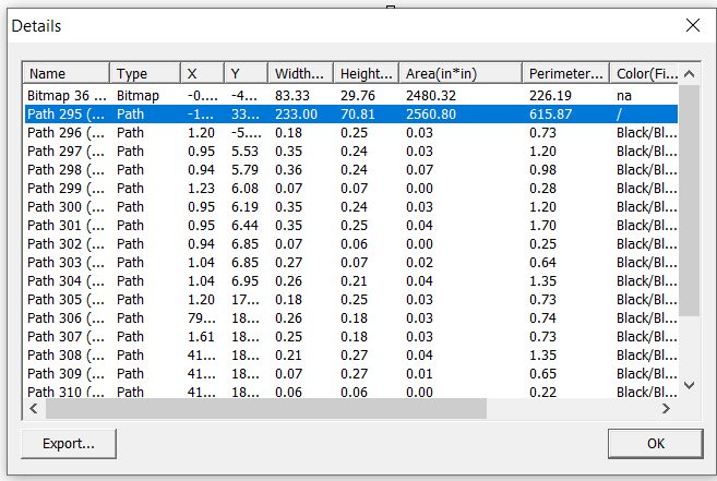

Flexi has that. go to the Edit menu, Job statistics, brings up a 'Details' matrix of everything you'd want to know. 2560.8 sq. inches
I had to trace your bitmap and scale it to come up with these numbers.... you can export the info as a text file, perhaps that would look fancy enough for your permit?
Path 295 (38 Points) Path -147.99 33.26 233.00 70.81 2560.80 615.87 / RGB/RGB
That is very interesting! Thank you!

This is easy. In Flexi, click Edit, the Job Statistics. It will show you the square footage of the design.

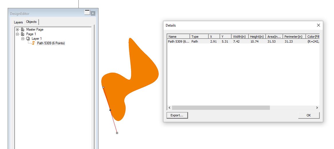

I used to do this all the time, almost every cad package has that functionality built in. Nanocad is a good free option similar to old school autocad, fusion360 would get you there but be harder to get a "drafty" looking print out of. I want to say that flexi has this ability as well but it is kindof hidden. Might be in with the meta data type stuff.
Evan Gillette
Yep, confirmed.
1. In Flexi put the shape into a new file (or if there isn't a zillion paths you can just select in and look at the DesignEditor to see what its called, for example "Path 5308".
2. Go to Edit>Job Statistics and find the path name with details.
3. Snip it and go shake it in the inspectors face...at your own risk.
