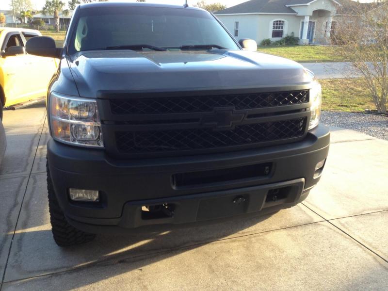

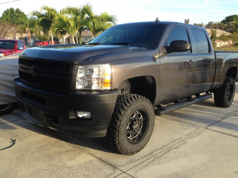

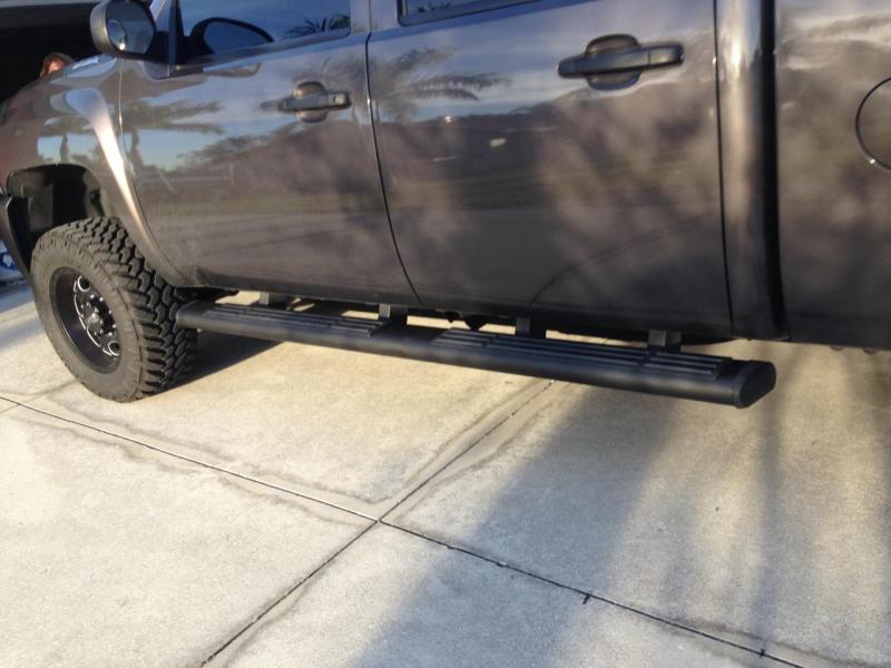

Well, got this project done.
Here is how it came out.
