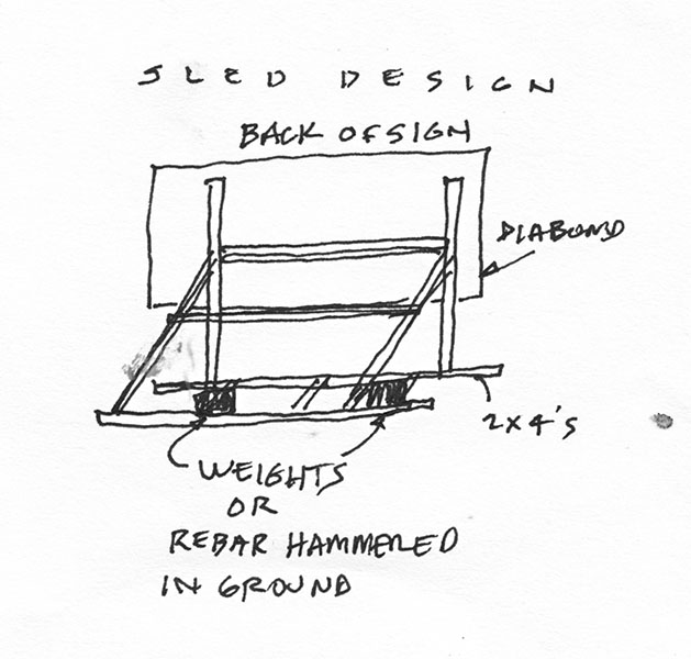

I think a 2'x2' sign would blow over with two 5 gal buckets of cement. If you made a wooden sled and weights on back would serve the purpose better and get you a bigger size sign to use.

I make 4'x4's and sometimes 4'x8' all the time on skids. That cement bucket idea is no bueno.

Billct2
Yep, like Texas and Johnny. Another variation is make it as a large A frame, add a couple cross members on the bottom for the weights. Speeds set up on site
