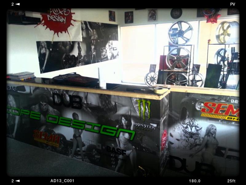

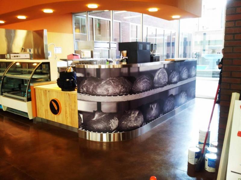

all 3m IJ35c attached.
0 lifting. 0 issues. Easy install. All drywall.
if you cant get it to work on drywall, you're doing something wrong.
Outside of not cleaning the surface well enough or not allowing the paint adequate dry time, what could we be doing wrong?
I agree, BTW. great work.
