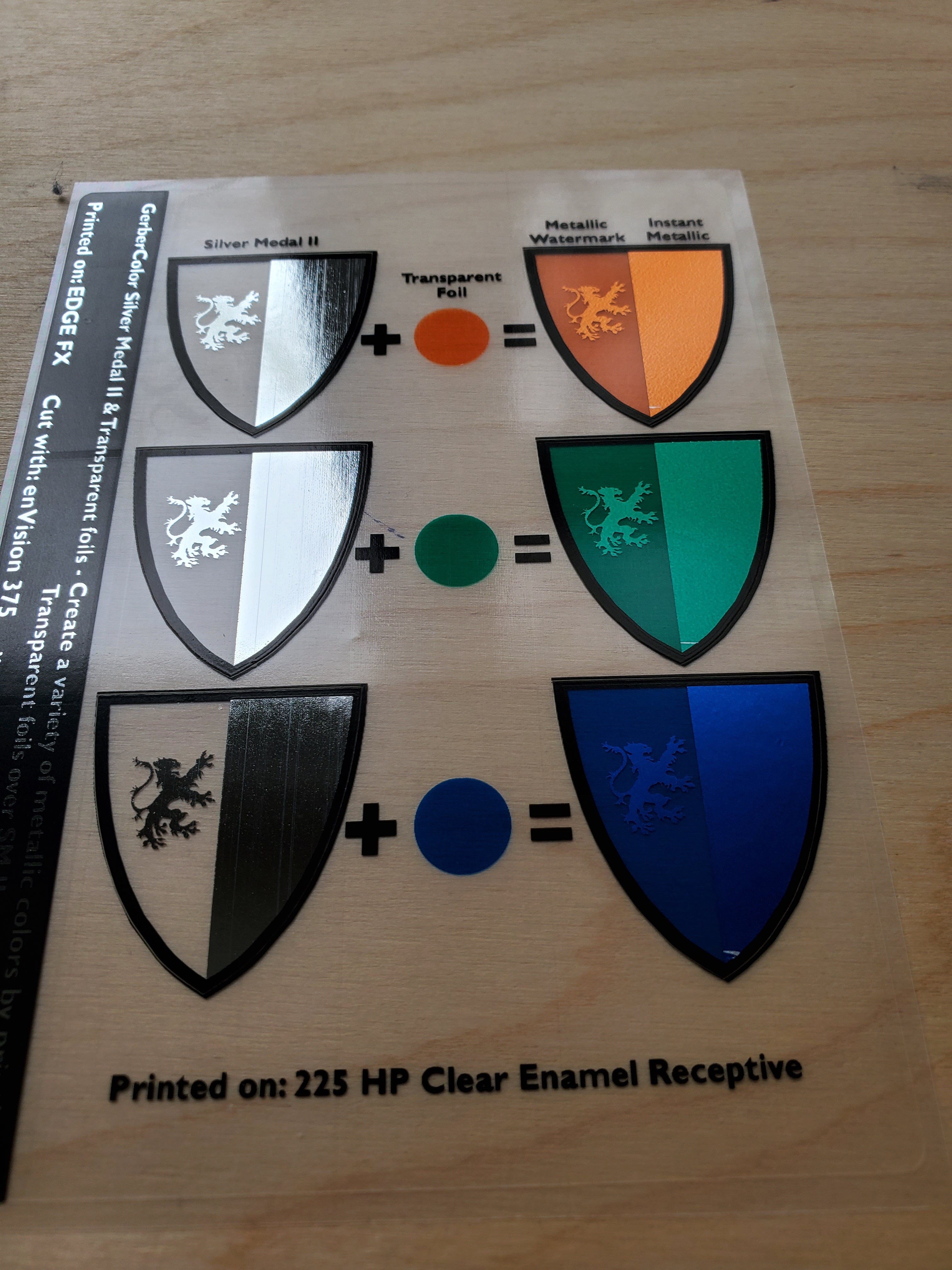

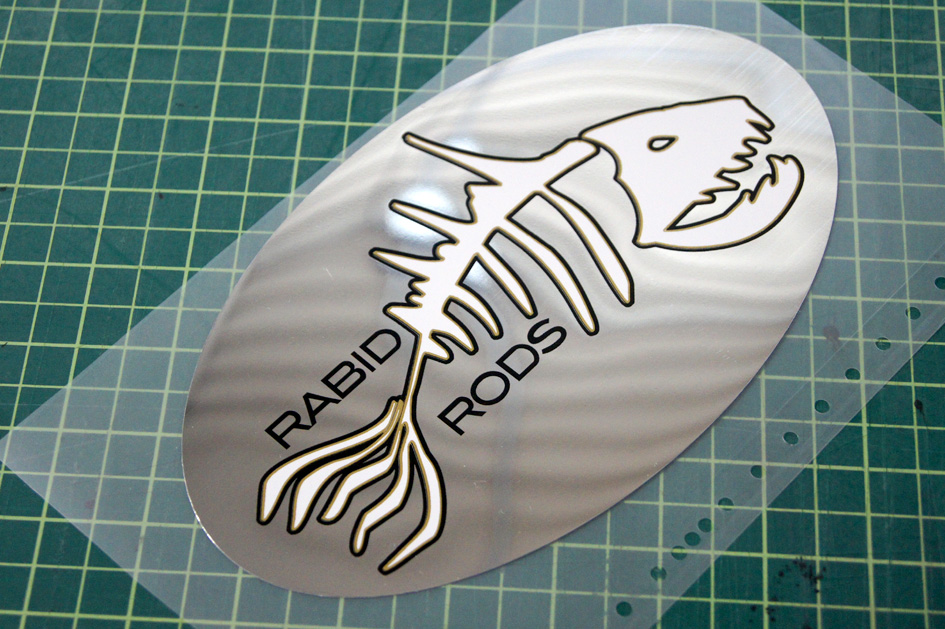

The Gerber Edge FX works great for printing on metallics and holographic materials. Here are some examples, no issues with full bleed prints.
