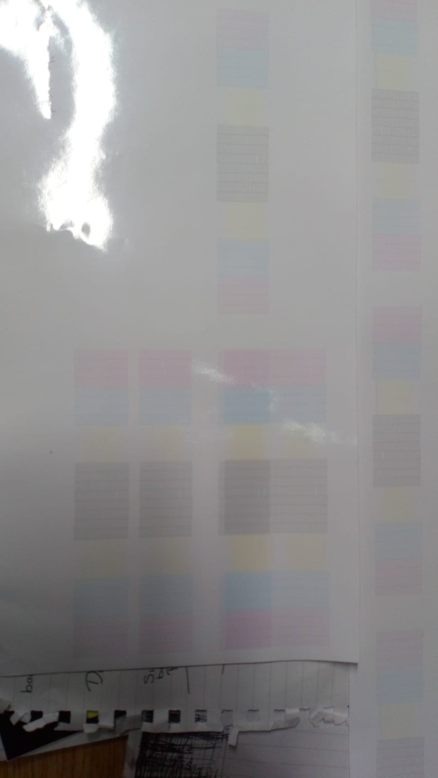

Please can you help We have a mimaki jv33-160 solvent printer. Has been running really well but recently realised when ink is running low or is empty does not detect this. We have to changeover ink when it is at 2 percent So in the long run a lot of ink wastage

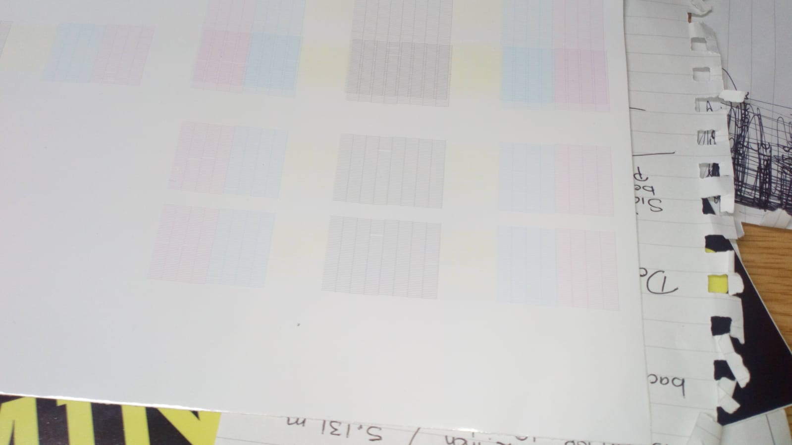

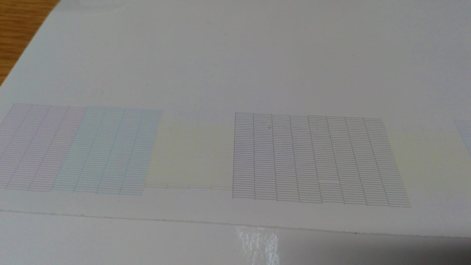

Secondly our test draw is missing a lot of nozzles especially on yellow. Please see picture. We have done nozzle washes. Filled ink changed the yellow to the next slot. We have done hard clean and still to no avail.
Please can you help as to what could solve this issue.

If you ran the lines dry, it could be air in the line, dampener issue, capping station issue, or a pump issue. If you have checked them all you might want to look at the print head, it might have dried up on you. You can look at soaking it in cleaner for a little while and than doing some strong test cleaning but you will go through some ink so be prepared for that.
If the machine is no longer in warranty you might want to look at an aftermarket bulk ink setup.
