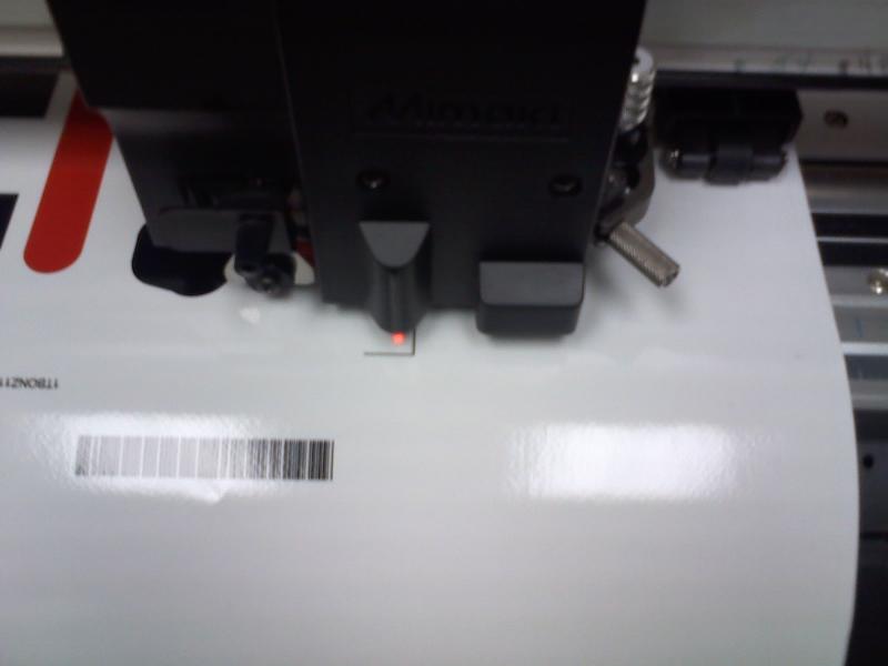

I've already made sure they are set to the correct crosshairs...wasn't the issue
NO, you do not.
Look at the video:
When you press enter - the laser moves down and to the right (instead of up and to the left).
Mimaki marks (at least here) are the inverse of what you have on your print. (the 4 corners of a box)
You put the laser within that corner's box and it moves down and to the right to find those lines with the sensor.
Also, you have to hit "remote" before you send the cut file AFTER it has found all of the registration marks and stopped at the origin point.

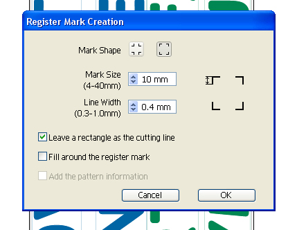

"kept messing with the "REMOTE" button, sent the file...and it started cutting but it didn't cut around the specified design."
In Mimaki's Fine Cut software there is a tab that reads "Registration Mark". Click that and there's a button labeled "Detect Mark". I don't know if there's anything similar in the software you are using (Flexi?)
Also, as
jfiscus points out the registration marks I use are the inverse of those you are using. Mine are as shown in the Mimaki software Dialog box attachment. As you can see the measurements are different as well.

Neither of ours have never made that "buzzer" noise when detecting marks, it just changes direction to go find the next mark.
In Flexi Sign you can change the type of crop marks that the printer creates. I have it set to Mimaki Type 1 (which are the lines it created in the video). Then on the plotter, I have them set to 'Type 1' marks which are the same. I made sure they were set to the same and not the 'inverse' of what I'm using, like you mentioned jfiscus.
