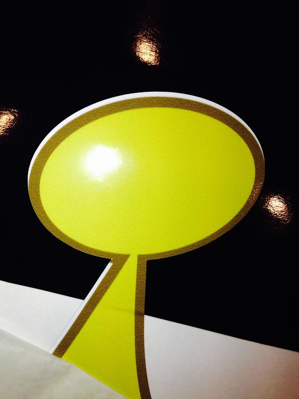

I am having problems with my Mimaki CJV30-130. I will print the image and it comes out perfect, but after I laminate it and send it back to cut its nearly impossible to align it so it reads all the marks and when it does the cut is displaced by a few millimeters. If the image is longer than 50 inches it will displace. Any help or tips are greatly appreciated. Below is an example of what I'm talking about. This was only a small displacement. I've had much worse.
