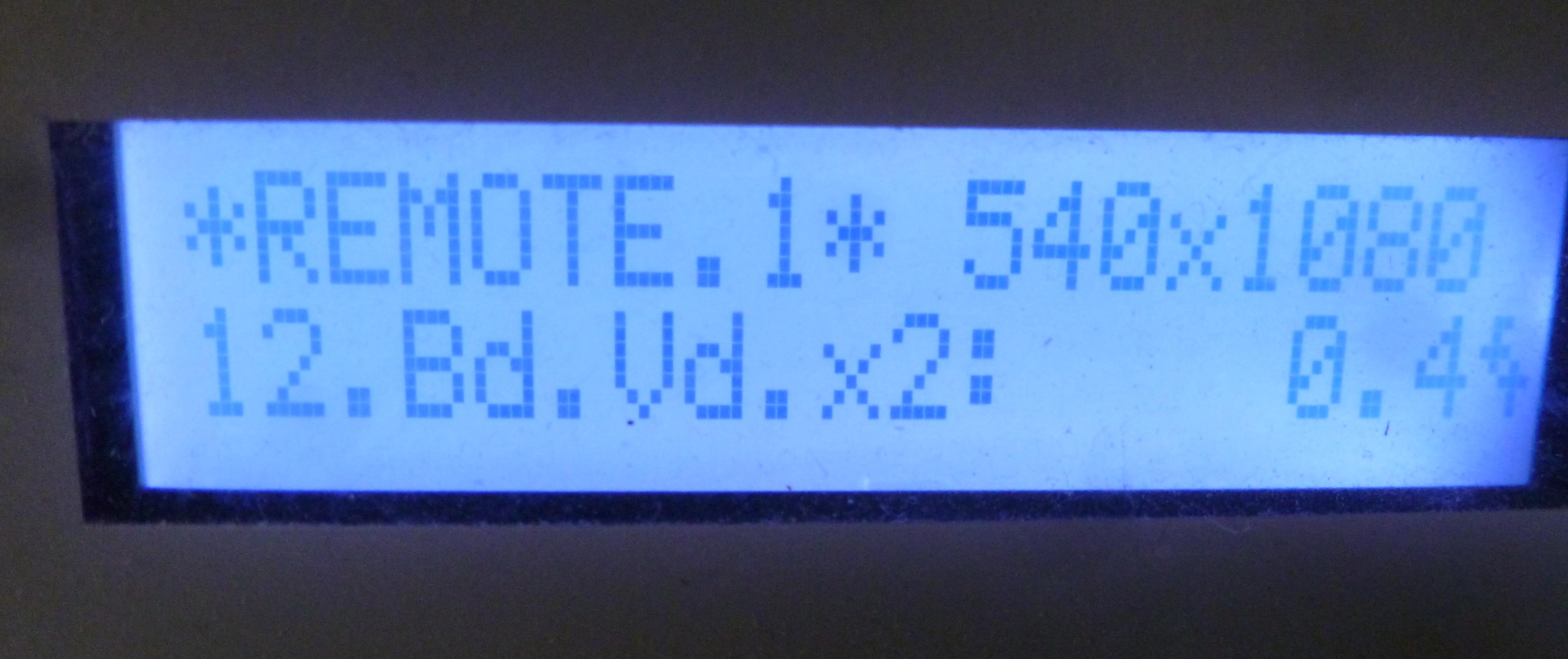

    Hi Guys, I was wandering if anybody knows what is this error that I getting some time when I send the file to Print? The Printer stop and after couple minute starts to work aging It dose once at while, here is a image of the LCD Screen, any help I will appreciate.

    That is the standard display that shows when you are printing.
    Remote.1 means you are in remote mode on user type 1
    540x1080 is the resolution you are printing
    12.Bd.Vd.x2 means you are printing 12 pass, bi-directional, variable dot I'm not sure what the x2 means but I think it might mean double strike or fast motor speed.
    the 0.4 at the end tells you it has printed 0.4 meters so far during this job.

    Thanks Vander for your help! It did Helps a lot.
