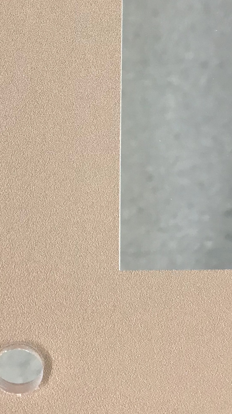

    We are running a Mimaki JFX200-2513. The rip that we are using is RasterLink6 Ver 5.15. When we print white over top of color (2nd surface), we are noticing that the white is slightly off. Can anyone tell me what I need to do to fix this?

    If the misalignment is in the print head travel direction, you just need to run the drop position alignment in the adjust menu. If it is in the up and down direction then you need to run the stagger adjustment in service mode.

    It is the print head travel direction. I will give that a whirl. Thanks!
