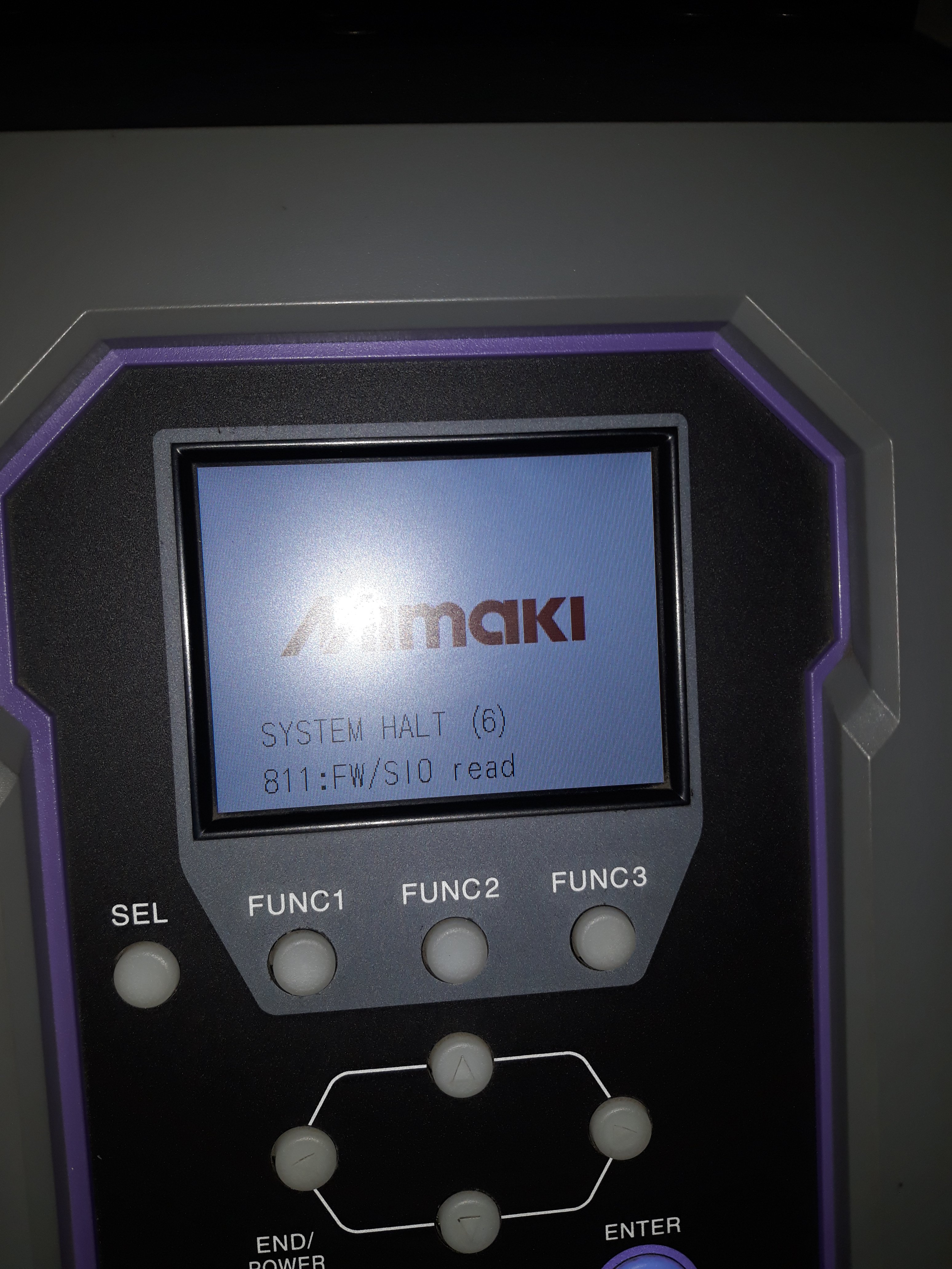

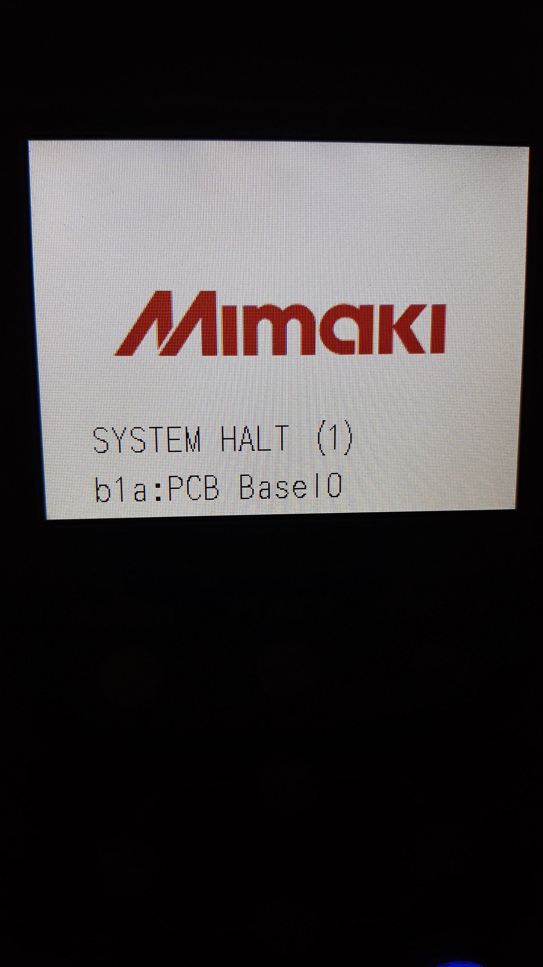

Hi, please help.
I have mimaki jv100-160 that gives me this error code after long weekend.
System halt (1)
b1a: pcb base IO

The first error you got, error 811, is basically saying the main board and I/O board aren't communicating properly. The second one means the I/O board is no longer detected. At the end of the day either a cable became unplugged or something shorted out causing damage to the boards and/or cables.
