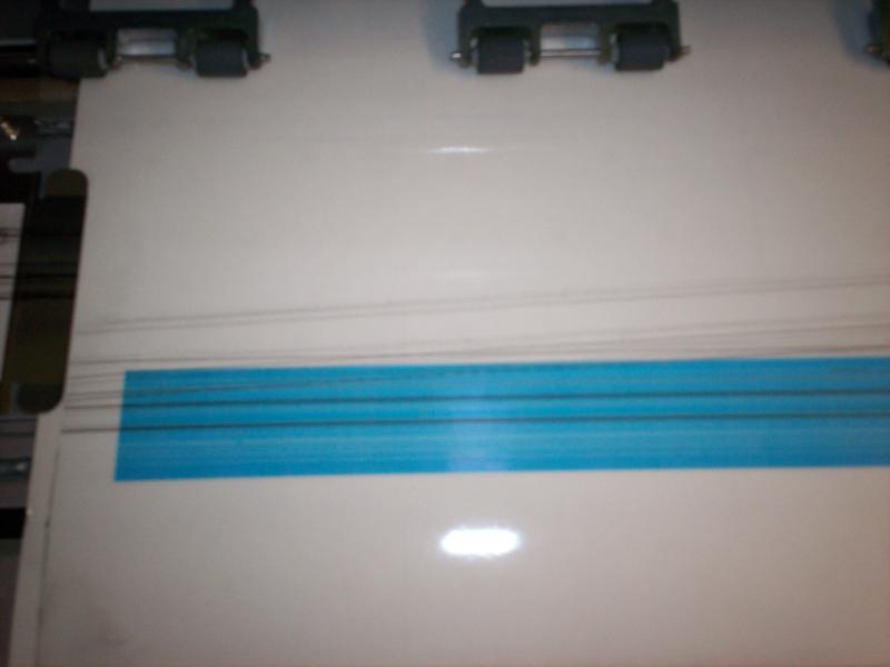

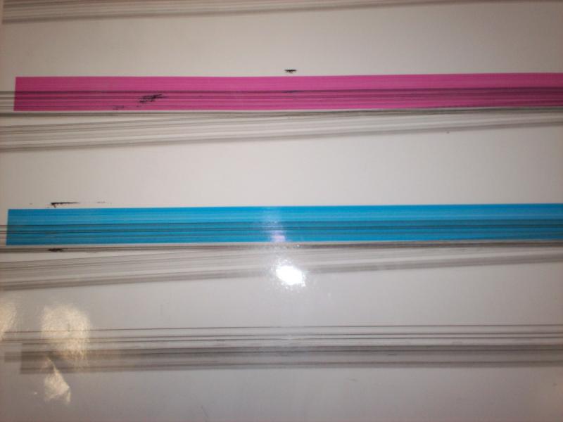

Know in maintance mode we done some test prints and as you can see from the attached image the black is always over the top of other colours, does someone know what would be causing this?
Thanks

Unfortunately the black head will need to be changed, when heads start doing this the electronics on them are failing. Also usually expect to see an error 07 head temp not too long after this problem appears.
artbot
it does look like a bad head. but! this is what my printer did with a loose black data ribbon. i'd check the ribbons and then do a data swap to prove if it is the head or slider board, or mainboard.

16skyline
If by data swap you mean swap the black head cables with another colour, I did that and as you can see it didn't make a difference. As someone else said about error 7, if I use black it will give me the error 7 code.

97GTB
As artbot said you can try swapping the head cables, but do the swap from the print head side not the Slider to rule them out as the cause. But given that you said the error 07 is coming up when printing black and that the machine sat idle for a year or so, id say 99% the head itself will be the cause.
