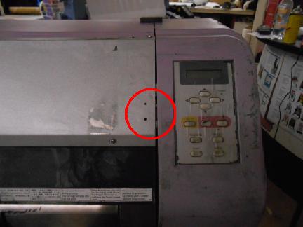

I received a use mimaki yesterday and one of the door sensors is broken, the one next to heads, my question is besides the sensor on the door next to heads is there more any where else, attached is an image of the door with the missing tap, but besides that one are there more or is that the only one, I keep getting a message to close a door on the screen

It might not be missing, look into where it would go if it was on the cover, alot of people including myself take them off and insert it into the slot so you can open the front cover while it's printing.
FLAGLOFT
There is three of these sensors, one on the door next to the heads, one on the cleaning station door and then one on the front clear cover, i take all of them off except the cleaning station door and put something in the sensor to hold it open, or the sensor could be bad all together

there's a magnet that holds the clip in (or the cover-down, if the clip was screwed to the cover), on the printer just behind those two holes on the cover. sometimes it shifts, and even though it is still there, it might not be making the connection intended.
also, the silver cap/cover that surrounds the capping station and heater switches & button... has a similar cap/cover on the left-side of the printer. that entire cover is also a "clip" that is intended to make a connection when screwed-in properly otherwise this cover/switch will also throw a "cover open" error.
