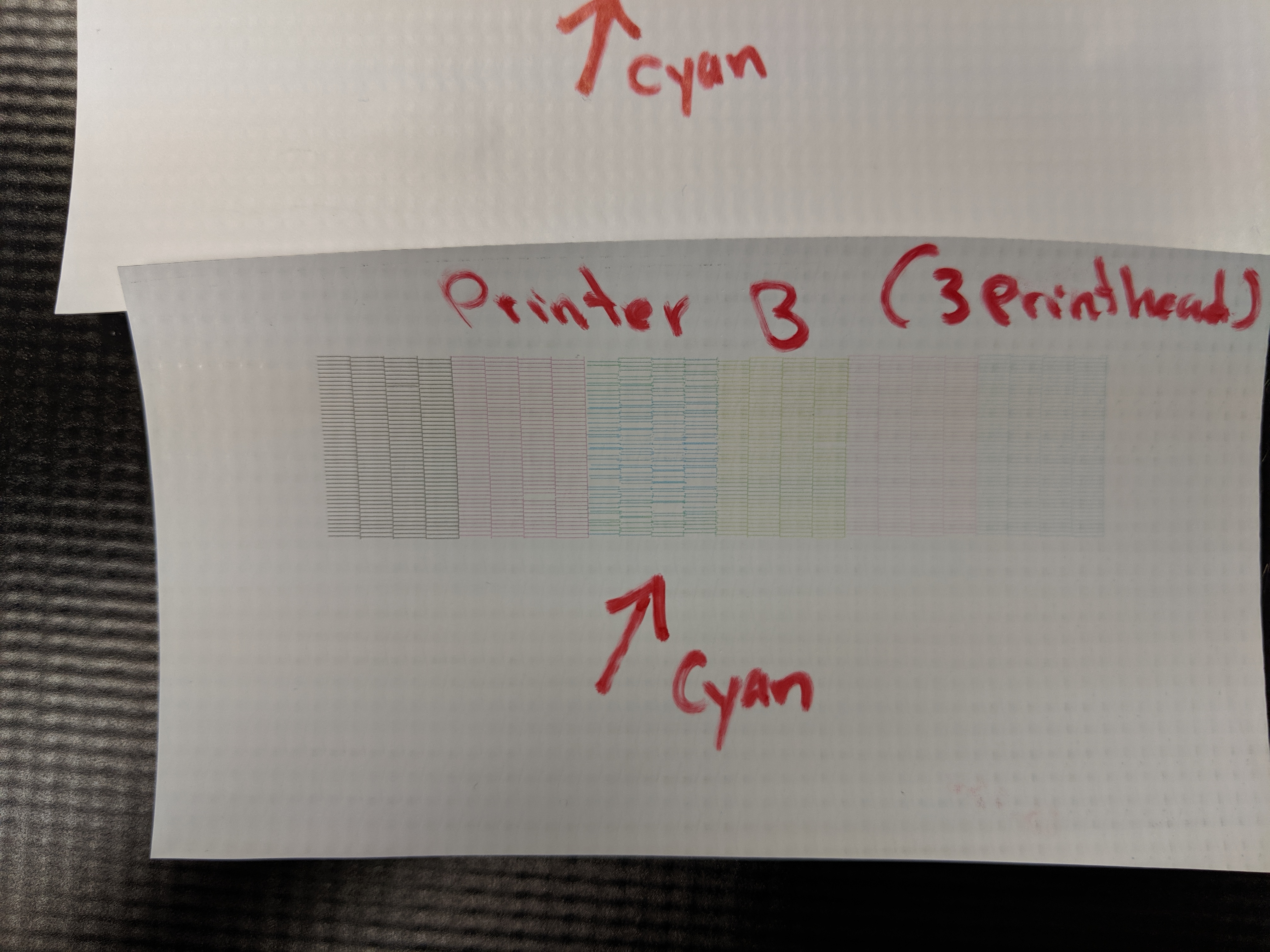

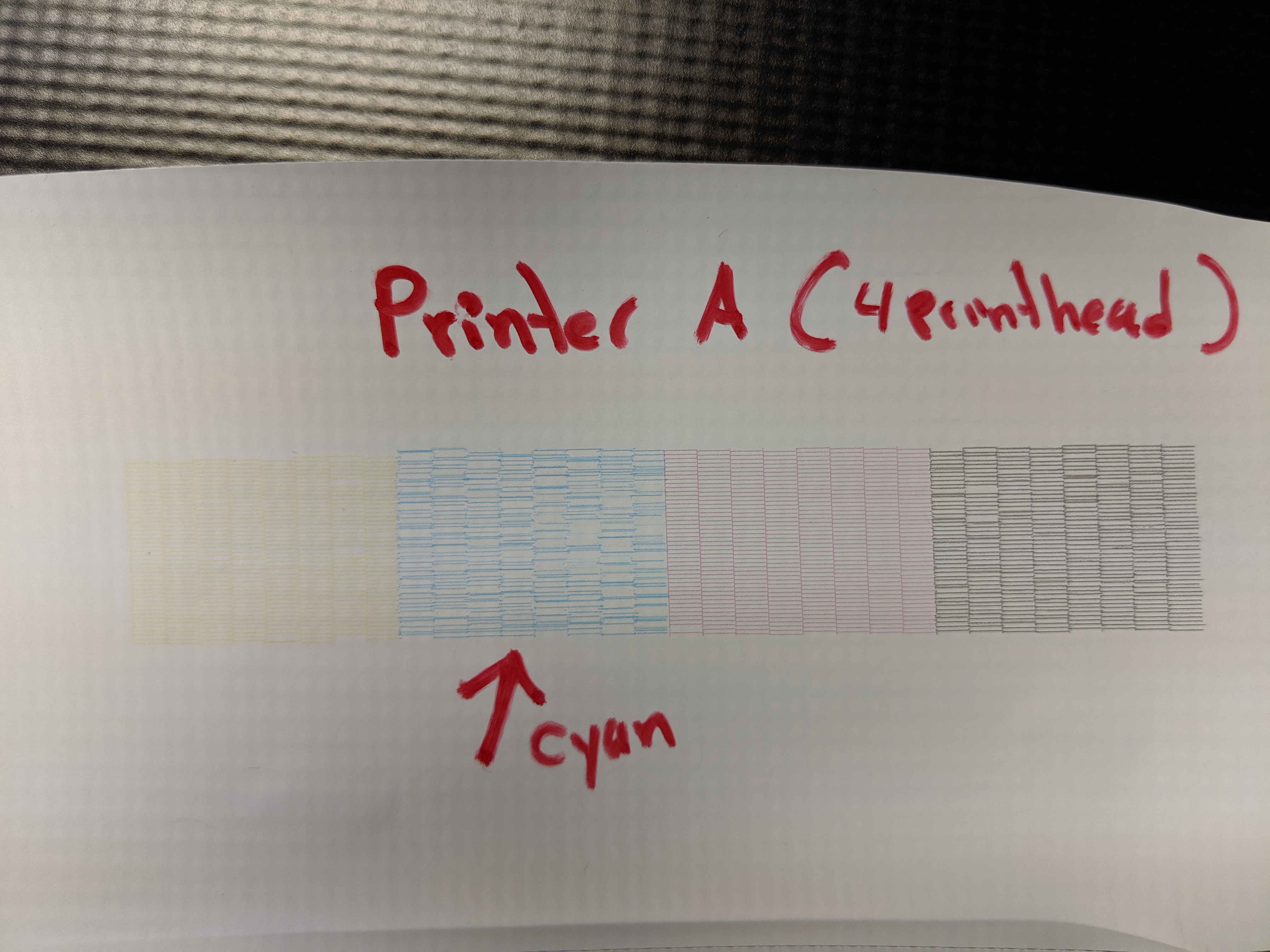

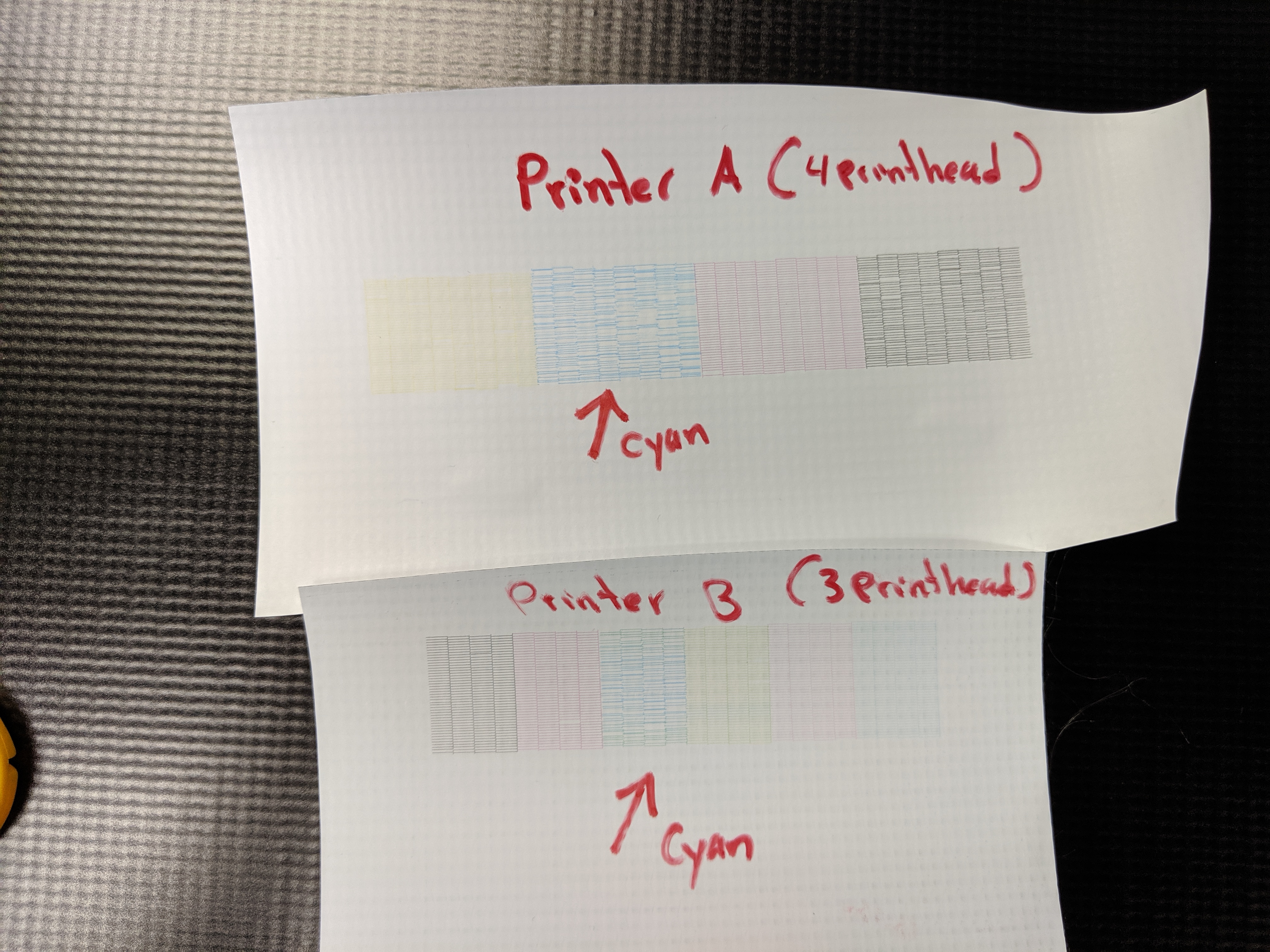

Here are some pictures hope for my two printers as you can see it's showing how de cyan color start failing and it's where l start with the original mimaki ink and the rest of the colors are okay all of them are the jet best

Yeah. But why when a put the original mimaki ink start going back to normal. It makes sense right. But well thanks.ill save those numbers t

Where did you buy the Jetbest ink? I can contact them to see why they are not taking care of you. If you want to be more specific on how long you have used the Jetbest ink. By changing the ink to another ink will not resolve the deflection. Give us a call so I can help.
