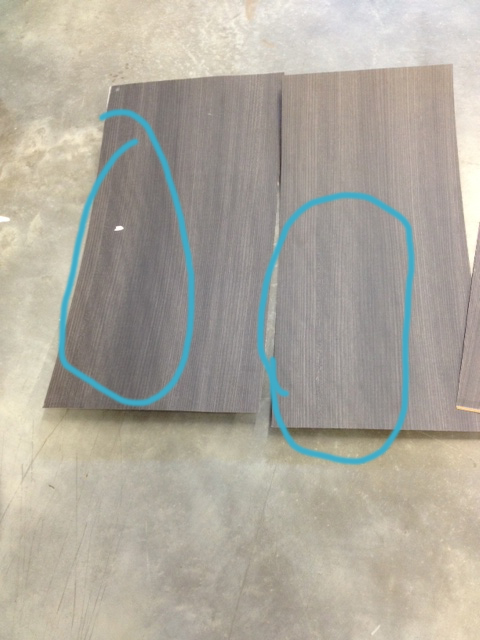

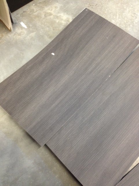

Here are some pictures of the wavyness i was talking about. you can see the darker angled lines. photo 1.JPG photo 2.JPG
MikePro
Yowsa. what material is that? laminate?
was the file supposed to be a solid-color print?
are those lines completely non-uniform throughout the print?
ima have to sit on this one a bit. Did that just randomly start happening or what occurred along the way from 100% printing perfect, on regular vinyl, until now?
hbb2008
i work for a company that prints wood decors on decor paper and turns it in to laminate flooring using a melamine resin. I create color matches and samples for customers before a color is sold and made into production. the verticle lines are supposded to be part of the print, the diagonal lines, are not. So far to fix this, printing uni-directional has worked. But I have only done it once and it seemed to work. I cant for sure say, it will be a permanite fix.
MikePro
i got ya. but essentially, the vertical lines ARE part of the decor paper you're printing on?
the file printing, itself, is just a full-field of color you've set?
pardon my million ?'s I'm no tech, but I stayed at a Holiday Inn Express last night. :)
can you post a pic of your test print and a pic of the same file printed on a regular white background?
still trying to wrap my head around this, but I'm starting to lean toward ink-starvation as the carriage travels across the y-axis, for the diagonal lines, but it appears that your field of color still has vertical dark/light/dark uniform banding, which would bring me back to encoder issues.
