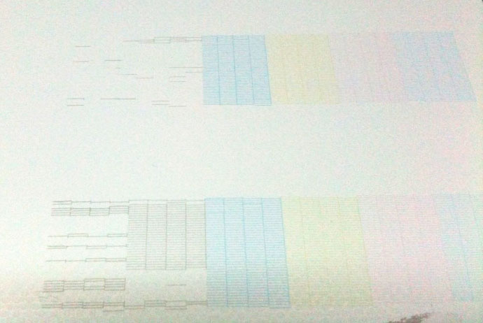

    Ok so I have tried flushing cleaning fluid thru the head to a degree of success, it fired back up and I now have half of my test on black and magenta! horrah! but then after a strong clean it went back down hill again!
    What gives? could there still be a small air leak somewhere in the damper or in the nuts the connect to it? seems strange as the ink is in the tubes with no air bubbles.
    pic attached of my latest test showing the success then not so much success after the strong clean.

    not sure if this will help but you might try using a syringe and draw the ink throught the dampers and the capping station, throughh the lines at the pump... It is a easy process. take off the cover on the back of the printer and look at the lines if you dont see any ink in them take them apart at thesplice and suck the ink through the system with a syringe..... Had a similar problem a month ago switching inks, after the switch my cyan would not print at all, did this procedure and workded perfectly.

    Basically I got round the back and pulled thru the ink as suggested and heard a nasty air leak as i pulled on the syringe from the capping station, seems the magenta black head wasnt fitting well on the capping station, luckily i managed to swap with the redundant white inks one for the magenta black one and hey presto were back in business!
